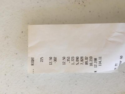

Look at my slip. Help me please
kwadkins
Oct 20, 2014
77
3v non intercooled stock pulley Paxton. LCA. Sway bar delete. Everything else is stock. 5-speed car. I'm left lane

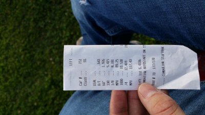

kwadkins
Oct 20, 2014
77
Second slip left lane

irishpwr46
Official Site Vandal
Apr 30, 2009
8,747
61
NYC
1.9 60's on a slick. youre having issues with traction for one

Tire pressure? Launch rpm? Slipping or dumping the clutch? Suspension setup?
Also, what gears you running?
kwadkins
Oct 20, 2014
77
15psi. Leaving at 4.5k dumping the clutch. Stock 3.55 gears. How's the MPH look?
stkjock
---- Madmin ----
Jul 10, 2007
40,257
3,171
Long Island NY
mph is good for 11.7-11.8 with a good 60'
Is it spinning, bogging?
What's your burnout procedure?
How old are the tires? What tire exactly
Townson
Jan 22, 2015
194
Alabama
Mph indicates you're spinning. That's how I see it anyway. We need more details bruh. Drag radials or bias ply tires?
kwadkins
Oct 20, 2014
77
Mickey Thompson et street. Not sure on age because I bought them used. I just roll into water box and spin them in 1first for maybe 5-6 second. Car kinda feels like it's bogging. I was comparing other people's short times and even with a better 60 I would still be a half second slower in the 330 foot ??
irishpwr46
Apr 30, 2009
8,747
61
NYC
definitely not getting them warm enough. you want to do a second gear burnout at around 50 - 60 mph for close to 10 seconds and get a good white smoke going. that "smoke" is actually steam burning off so that will tell you about how hot the tires are getting
Townson
Jan 22, 2015
194
Alabama
You're doing a burnout in the water? That's no bueno.
Here's what I do: Go around the water, put the car in reverse and back into the water. Spin the tires over just a little. Pull up a few feet in front of the water box and rev to 4 or 5k, dump the clutch and hold the brake. I don't do that long of a burnout. Maybe 3-4 seconds, but you may need to do it longer since you're making more power.
If they're et street radials then 15 psi is way too low. At the least you should try 18 lbs. hot.
If you're bogging at 4500, then try 5000 and from then on bump it up by 200 rpm's until you get it to spin a little. Then back off a little.
stkjock
---- Madmin ----
Jul 10, 2007
40,257
3,171
Long Island NY
/\ this, but you should only need 4-5 seconds IMO at 55ish MPH
Okay. What RPM do people usually leave at?
I left at 5000 with a radial. You should leave higher with a bias.
15 is to low.
You can check the age on the sidewall. There is a four digit code, month and year of production.
NickD87
Sep 21, 2013
602
10
Toronto, Canada
still dont know what tire your running
first it was slick then et street.. bias, radia, size needed
You also prob want more gear with the paxton
kwadkins
Oct 20, 2014
77
26 inch ET bias. I'm sorry I said slick due to the tire being very close IMO to a slick. What about 4.10 gears
stkjock
---- Madmin ----
Jul 10, 2007
40,257
3,171
Long Island NY
4.10 and 26" tire are a good combo for a centri blower.
Are you power shifting?
Five Oh Brian
Mustang Guru
Feb 28, 2010
1,687
17
Pacific Northwest
My '07 GT was very similar to your car. Vortech V2 non-intercooled, but an automatic. I ran similar trap speeds, but ran 11.80's with it. Only had a few mods on that car: 4.10 gears, 4800 rpm stall converter, 26" M&H Racemaster D/R's, and custom dyno tuning. The steep gears and high rpm launch really helped get the centrifugal blower into the boost quicker to get the car into the 11's.
As others have said, your trap speed indicates a high 11 second car. Just need a harder launch to get there.
