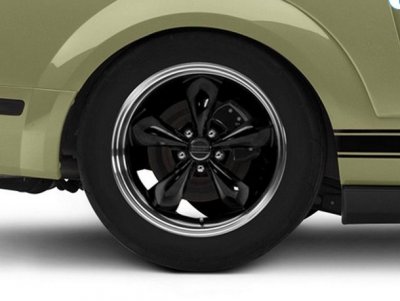

To make a long story short I need a couple of wheels in 18"x10" with a +45-+50 offset. I've looked for a little while but can't seem to find them in the right size and offset. I thought it would take about two minutes but I keep hitting walls. Was trying to avoid AM because of quality issues.

That looks really close to the Torque Thrust M 18x10
Thanks. Yeah. Similar enough but the ones I’ve been finding are either the wrong offset or wrong bolt pattern. When I call them they say they don’t know when they will be able to order them for me. I have time today to do some more searching.

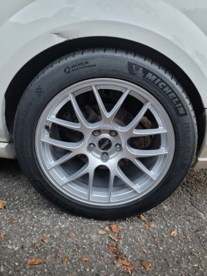

This is what I’m rockin’ as a temp set up and it just looks hideous.
Those were the largest tires I could find in town that would fit my 15”s.

is this the right offset and backspacing?
Wheel Size : 18x10
Bolt Pattern (inches) : 5x4.5
Bolt Pattern (metric) : 5x114.3
Backspace : 7.27 inches
Offset : 45 mm
Full Finish : Gloss Black with Machined Lip
Center Cap : Included
Weight : 26lb
Wheel Lip : 2.91 inch
Rim Material : Aluminum
