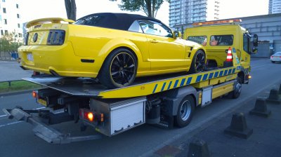

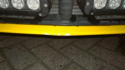

Hit the curb very gently yesterday during parking but hard enough to trash my Afco Heat Exchanger with fans :(
Coolingfluid came pooring out so I knew I was done driving.
Problem is that I have some extra high beams installed in the bottom grill and they were really close to the HE. So by touching that curb the bumper went back for maybe 3/4" but that seemed to be enough.
To save on costs I just hope that those fans can be tranfered to a regular Afco dual pass HE without fans because they are still working perfect.
and so the bad luck continues ...

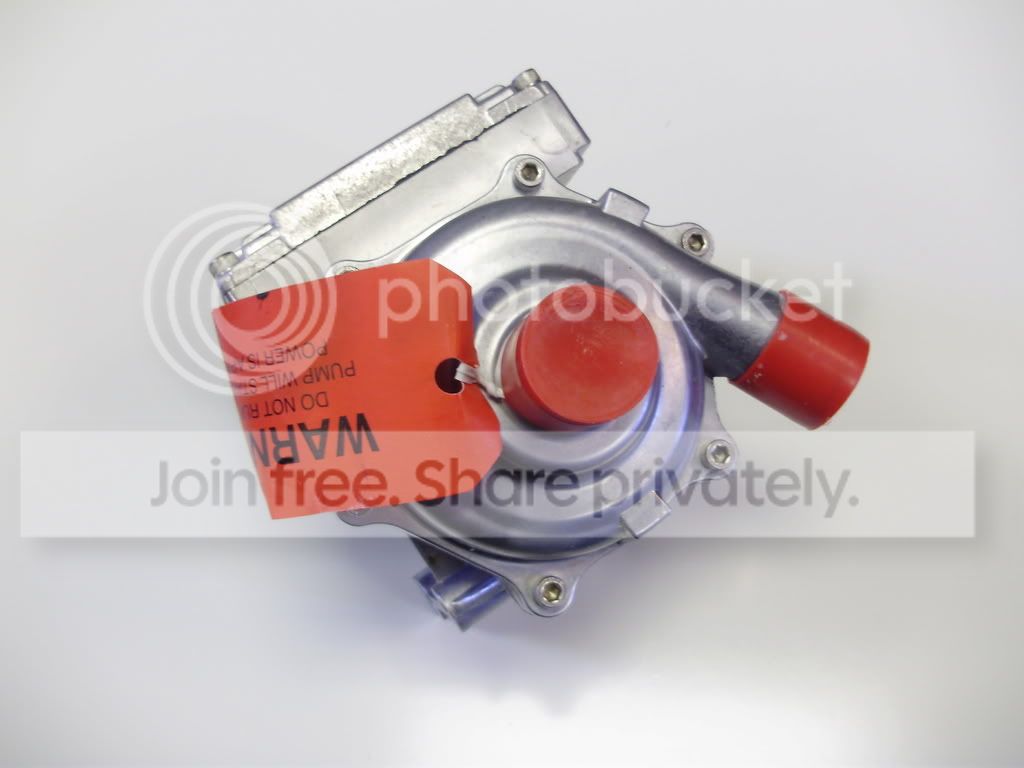

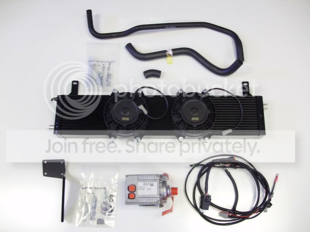

Below are pictures of my complete cooling system components:
http://www.brenspeed.com/m-8c607-msvt.html
I think I just found the pictures where George is installing the Up-Graded {Intercooler}.
I did stumble on a few pictures of the PA 130 Amp Alternator.
Philip,
I finally found the invoice for what I have.
It's the Saleen Extreme Heat Exchanger W/Fans 05/09 Mustangs.
http://www.brenspeed.com/10-2000-a18000.html
I now remember that I went with the Saleen system simply because I had the Saleen S/C with the Super-Shaker option.
If I did not have the Saleen I'm sure I would have gone with the Afco unit !!!
Saleen Heat Exchanger upgrade kits !!! Thats right the wait is over! Saleen has finally let us know that they are ready to start taking orders on their Heat Exchanger upgrade! This kit comes on the 2008 Saleen Extreme S302 Mustangs. In testing at Saleen they noticed temperature differences of nearly 40 degrees under extreme heat soak conditions. This can mean up to 40 HP while at these higher temps! Everyone knows that after you drive your car around for a while and get it up to operating temperature, especially on a warm day, that the power band will drop and a noticeable difference in power is felt. The exact opposite, on a cool day your going to see much lower supercharger coolant temperatures and make more power! The idea of the Updgrade kit is to keep you from those heat soak conditions and giving your supercharged mustang that monsterous power band all the time! The Heat exchanger upgrade kit comes complete with a Heat exchanger that is 58% larger than the stock unit!! This is over twice the size of your factory heat exchanger allowing more air to pass through and cool the superchargers fluid. Not only is the size of the heat exchanger improved but Saleen has also added dual cooling fans! These fans are great for in tracffic and quick cool down situations. They are not too big so they don't cover enough surface of the heat exchanger to block air from flowing through when you have a clear path for air flow. This larger, more efficient unit, with dual cooling fans is only part of the reason why this upgrade kick is so great. To help move more coolant through this massive heat exchange Saleen has also included an upgraded intercooler pump! This pump is a varialbe speed water pump that is preprogrammed by Saleen. Its actually able to increase or decrease the voltage to change the speed of the pump! EMP is the manufacturer and with a simple download software and cable you can program the pump to flow at whatever rate you want!! Im waiting on exact specs from Saleen on where they set their pumps when they leave the factory, all was able to find out was that it is at a much higher volume rate than the Bosch pump supplied with the standard kit! The ability of this pump to flow more fluid and move it quicker through the system means your going to increase your chances of keeping your car at a much lower coolant temperature! These kits come complete with Hoses, Brackets, Hardware, and installation instructions. Not a thing is missed in this kit, A complete wiring harness is also included to run the new dual cooling fans and EMP intercooler pump! These kits have been introduced by Saleen speedlab at a price of $1399.99. I have heard through a very reliable source that this is just and introductory price and will be raised to $1499.99 some time in the near future.
Read more at: http://www.modularfords.com/threads/107415-Saleen-Heat-Exchanger-upgrade-kits-!!!
Terry
