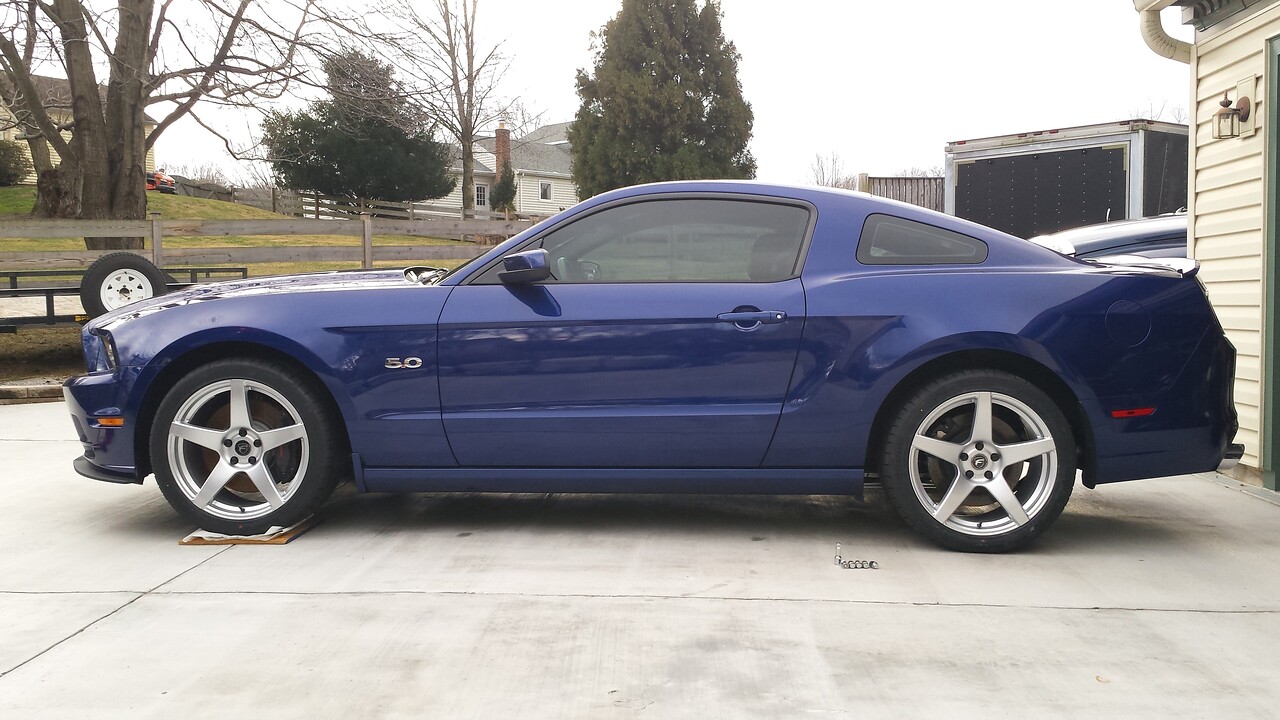

ForgeStar CF5 would look good on your Mustang and follow with the five spoke and not black theme you seem to prefer. The below shot are 19x10s with 285/35 mounted at all four corners.

I really like the clean simple CF5 wheels. They also have CF10's I really like.
