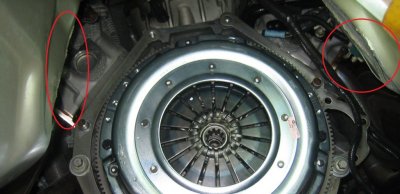

Ugh! This is not fun. I got the trans bolts loose and the trans moved back, but the slave cylinder line elbow is smack hard against the tunnel, so I can't get it further back to clear the clutch in order to drop it. I could rotate it but that would mean loosening the safety chains on the jack, which I'd rather not do. Plus, the engine won't drop any more at the rear, this is with both motor mount bracket to isolator bolts loose and the jack under the oil pan loose. It definitely looks like I'm lowering the K member tonight.

I know. Its a pain. The trans is big and the tunnel is small. Its a bitch of a job. Rotating the trans does help.

Well I fooled around with a little more last night, but ran out of time. Incredibly, the front of the trans will have to come down at least 3" in order to move rearward enough in order for the input shaft to clear the PP. I put a floor jack under the oil pan and k member with a block of wood across both, then loosened the front k member nuts and removed the rear bolts and replaced one on each side with a longer bolt from the trans x-member. This dropped the back of the block about 1", but I'll still need to drop it further. The next step is to get a couple of longer M12 bolts, maybe 100mm or longer. These will go in a rear mounting hole on each side to keep the k member somewhat in place while I lower it and the engine together.

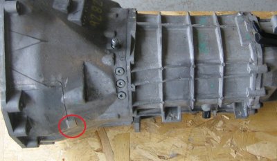

I agree. I remember changing top loader transmissions by laying them on my chest, sliding under the car and installing it by hand.
There are 2 aluminum ears on the trans that you can cut off after its out. That will make putting it in a little easier. I also took a hammer to the front of the tunnel and dented it in a little for more room.
