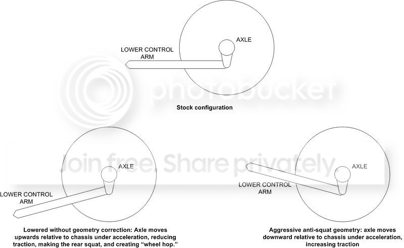

If you're just looking to lower the car, then an adjustable panhard bar, a set of lowering springs, and maybe a set of camber bolts should be all thats required. The axle will shift over to the drivers side once the car has been lowered, and it becomes more apparent with wider wheels and tires. Some people choose to forgo the adjustable panhard bar, and thats fine. Nothing bad will happen to your car, but you may rub with wider wheels and tires. You may not need the camber bolts depending on which spring you ultimately end up going with. Most of the ~1.5" springs will still leave you within OEM specs.
It's also a good idea to pick up a set of LCA relocation brackets, but they aren't required. Just bear in mind that your axle will tend to lift instead of being forced to the pavement, decreasing your ability to get traction.
People using my diagrams makes me happy.
