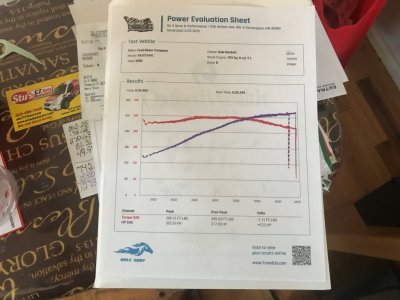

We put her on the dyno today & got her all tuned up w\ these Lunati VooDoo #21270700 cams installed (only item that was changed on the engine that will matter....replaced OEM Ford production cams & also replaced OEM valve covers w\ FR Black Wrinkle Etched valve covers--bling).
1st thing to put into context, the new On3 Performance speed shop uses a Mustang dyno instead of a DynoJet dyno that Optimum Force (the shop where my tuner was contracted thru during the initial tuning work) uses so we aren't gonna be looking at apples to apples comparison w\ the prior dyno sheet I posted earlier. Both dyno sheet's results were corrected @ SAE. The best we're gonna do here is use some math to get a better comparison as my tuner said that the difference between the 2 dyno types typically falls between 8%-10% depending upon equipment condition\setup\calibration being relatively on par as long as the correct weight of the vehicle is loaded properly w\ them. Was told that a Mustang dyno will usually induce a heavier load on the drive wheels vs a DynoJet w\ all else being equal thus why they usually show lower numbers. The main thing thru all of this is how does the car drive\feel\perform after tuning vs before.....the drag strip\road course is usually the better place to determine this as they are timed events that can reveal the general total improvement\regression of the parts installed/work done.
But there is data to be gained from looking at the dyno sheet showing "area under the curve" performance.....
Now that that's out of the way, here she is...……………………….

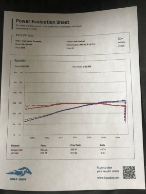

At peak final numbers were 317.02 HP/299.23 TQ (vs 317.90 HP/295.47 TQ baseline) w\ the Lunati VooDoo #21270700 cams on On3's Mustang dyno. This correlates to DynoJet correction of final On3 Mustang dyno peak numbers of same FBO's running Lunati VooDoo #21270700 cams to compare to OF DynoJet peak numbers using math of same FBO's running OEM cams at 8% @ 342.38 HP/ 323.17 TQ or at 10% @ 348.72 HP/ 329.15 TQ so the net final peak comparison at 8% @ +11.78 HP/-2.73 TQ, at 10% @ +18.12 HP/+3.25 TQ vs the OF dyno sheet results. As you can see, the On3 dyno sheet doesn't show the final peak HP/TQ RPM markers to compare to the OF dyno sheet's peak HP/TQ RPM markers where peak numbers were reached (forgot to ask my tuner for this info at the time but can get it later) to determine the shift in the curve higher or lower. Now looking at the On3 sheet at 2500 RPM (low end of graph) we have final peak numbers of 139 HP/285 TQ (vs 125 HP/245 TQ baseline....measured 5/8" between HP/TQ markers which gives 9-1/16" "scaling marks" so matched up w\ graph) w\ Lunati VooDoo's. Using the same math to correlate to the OF DynoJet sheet at the same 2500 RPM mark w\ OEM cams (final @ 130 HP/270 TQ) the On3 Mustang sheet to DynoJet correction finals at 8% @ 150.12 HP/307.8 TQ, at 10% @ 152.9 HP/313.5 TQ so the net final comparison at 8% @ +20.12 HP/+37.8 TQ, at 10% @ +22.9 HP/+43.5 TQ @ same 2500 RPM. So assuming all is theretically apples to apples, the Lunati VooDoo's are giving a larger performance gain at lower RPM's than at upper RPM's vs OEM's.....for HP the gains are across the entire curve at both 8% & 10% corrections but for TQ the gains are larger at lower RPM's for both 8% & 10% corrections but at 8% peak TQ correction we lose 2.73 lb\ft vs 10% peak TQ correction we gain 3.25 lb/ft.
Now notice the dip in HP & TQ right off the 2500 RPM mark on the On3 dyno sheet then it levels into the steady rise from there. This happened from the ECU doing what I posted about in post #19 as I am still running cats so the ECU is still using the 2 post cat O2 sensors....my tuner has this recorded as well (I'll see if I can get a copy of the data logging that shows it). He had fixed this as best he could under the circumstances by resetting the VCT cam retard setting limits to get the most HP/TQ down low but still not screw up the cats so I'll have to live w\ that unless I remove the cats & turn off the rear O2 sensors. Good thing is when driving the car I never really noticed it thru these 3.73 gears/26" tires so a moot point.
The other things we noted is that around 3500-3800 RPM there is some outside harmonics going on that is causing some false knock so ECU pulls some spark timing momentarily then it goes away after that. I think I know what's going on (got exhaust piping\clamp most likely hitting unibody due to vibrations from exhaust frequency within this RPM range....I noticed 1 clamp is actually touching gas tank guard but may also be 1 of the cats hitting underside from me having exhaust supports installed on mid pipe at trans crossmember....all is very close to unibody, may be hitting due to exhaust piping moving from expansion) so I'm gonna pick up some 5/8" flat washers to use as spacers to gain some more clearance & rotate the 1 clamp to clear the gas tank guard...should fix this. Also around 5700 RPM the engine starts to run out of air (injectors DC around 78%-80% so FP is keeping up so fuel delivery isn't the issue) but not enough to cause the HP/TQ to nose dive so HP is still slowly gaining but at a slower rate. My tuner thinks that this is due to the limits of my FR Bullit 85mm CAI, not due to the Lunati VooDoo #21270700 cams. He says from what he's seeing these Lunati VooDoo cams (thus my engine) got more gains to give up on top, but since these are a mild cam grind to begin with & this would only be important to go after if racing was the goal (which would be better served here w\ a more aggressive cam profile along w\ a SC install anyway & racing is FAR down on my list of priorities w\ this Glass Top Stang due to it's rarity) I'm gonna call her good at this point.
Had the hot idle set RPM lowered from 790 to 750 (I had raised idle RPM back when engine was all stock on OEM 87oct Ford tune w\ 3.55 gears due to struggles on TO w\ A/C on & just left it as set until now). This brought out the exhaust cadence more (not a chopping lope but a rolling rumble) that I was hearing after I installed these Lunati's along w\ an even deeper exhaust note thru my Pypes Super Bomb Mid-Muffler catback system w\ them 14" x 4" resonators....sounding sooo good to me now (wife told me that she heard me backing into driveway from the back bedroom of our house thru closed door......neighbors ain't gonna like me driving in\out at night). The rumble is fairly smooth but no resemblance to the sound from the OEM cams, probably due to the slightly larger valve overlap in the Lunati's. With the increased low end torque gains from the Lunati's vs the OEM's the car drives even better than before even at the lower 750 RPM idle w\ the A/C on to boot....just walks off in 1st w\o any throttle input & the power comes on very smooth but QUICK once throttle input is applied so she is a little more touchy than prior on throttle management at low RPM but this I LIKE.
Was starting to rain so I parked the car for the rest of the day. Plan to take her on a ECU relearn drive in the AM if weather permits.
So all in all I'm happy w\ these Lunati VooDoo #21270700 cam's performance vs the stock OEM cams....should make cruising a very pleasant & fun experience!

It's a shame you couldn't use the same dyno as previously but what stands out is how much flatter the torque curve has become with the Lunati Voodoo cams. While peak TQ is virtually unchanged, the TQ output has increased on both sides of the peak. HP is also still climbing beyond 6000rpm.
These cams are advertised as having an operating range of 800-6500rpm and they certainly deliver on that. Perhaps you should try the JLT series 3 110mm CAI. That'll deliver more air and you could see a further boost in the mid-range and top end.
I have to say overall I'm impressed with those cams and they seem to compliment the FRPP intake manifold very nicely.

Yeah would've been better do this on the same DynoJet dyno but I thought it wiser to stick w\ the same tuner than stay w\ the other shop.....besides I still got the same deal by going w\ the tuner....only costs me $250.00 + tax for the tune upgrade w\ unlimited # of pulls (initial tune cost $500.00 + tax unlimited # of pulls). Only took him 3 drivablilty tweak runs & 2 WOT pulls to get there after making changes in the tune calibration to match up w\ the Lunati cam card data so the ECU can manage engine operations more efficiently.
I might do that if I run across a used 1 at a steal of a price....this is the CAI that my tuner tried to talk me into getting the 1st time he tuned my car but I had already bought the Ford Bullit CAI prior & he didn't fail to mention it to me again when finished w\ this session...………..

My tuner finally got back to me w\ the peak HP/TQ RPM markers for the new dyno sheet...……. she hit peak HP numbers at rev limiter @ 6750 RPM's (obvious due to graph.... vs prior peak HP @ 5800 RPM's), she hit peak TQ at 4871 RPM's.....471 RPM's higher than when she did on the prior graph (prior peak TQ @ 4400 RPM's). Now this part of the data IS relevant due to the same rear tires (read 295/35/18 @ 26" dia here) & same rear gear ratio (3.73) being used on both dyno rollers applying the same leverage coeff to the rollers & both sheets show no evidence of tire slippage on the rollers so the results here show that the new peak HP\TQ markers carried higher up the curve vs prior.....verifies that these Lunati VooDoo #21270700 cams are indeed a more powerful, more efficient cam than OEM cams across the board & that there is more HP/TQ left on the table to gain from these cams in NA form. Just would need to open up the induction (CAI > 85mm) some more to let her breath.....
So if a good used JLT Series 3 110mm CAI assembly is out there somewhere for a good price I might be tempted.....
All in all a good problem to have!

Yup, and you'd need to revise the tune and do another dyno run for the larger JLT. On a Dynojet you should get 350+rwhp.

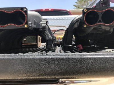

Finally got under her today to check the exhaust system for clearance & indeed found 1 exhaust clamp (bolt side of exhaust clamp) on 1 of my Pypes M80 mufflers had been making contact w\ the gas tank shield....rotated it to clear the shield. All rest of exhaust checked out for clearance so no need to install spacers under mid pipe hangers....this should solve the detected false knock occurring around the 3500-3800 rpm area during drivability/WOT pulls at the last dyno session so she "should" make more HP/TQ in this area now due to ECU not pulling spark timing away (engine was happy showing no knock detected below & above this RPM zone of the pulls....only set off the knock sensors momentarily within this zone on each pull so tuner knew/suspected something else was triggering the knock sensors outside of actual engine detonation & exhaust harmonics is the #1 suspect as it is physically mounted to the engine heads thus can transfer harmonics to the knock sensors mounted on the heads causing a false signal to be sent to ECU.....).
Also noted today that when the A\C is turned on the load from the A/C compressor actually smooths out the idle cadence to a steady rolling rumble, when the A/C compressor is turned off the engine exhibits a slight "lope like" but fairly smooth rumbling idle cadence.....distinct enough to be clearly heard to let anyone know that it ain't an OEM cam idle sound cadence.
FYI...……………………………..
Also realized that w\ the hood up & car stationary during dyno pulls this is defeating 1 of the FR 85mm Bullit CAI's design strengths....true ram air effect when hood is closed sealing on the CAI's open filter shroud & car is in motion (cooler air will then enter thru opening from behind the Lft headlight assembly & thru grille area behind Lft fog light in front of the core support due to the low pressure area created at front of CAI shroud on top of core support (open area between core support & hood for air entry to CAI's cone filter...faster you go the more air is rammed into this area to feed the engine due to increased deltaP)). Ford used this very CAI on their 08-09 FR500C race cars (saw 1 FR500C car w\ this same CAI installed while the hood was raised during a YouTube video) & loss of this effect will show up w\ this FR 85mm Bullit CAI during a dyno session w\ the hood raised. Won't make up the flow difference you can get thru a JLT Series 3 110mm CAI w\ hood closed but it should make up the amount of air loss detected during the dyno pulls w/ the hood closed & car in motion to create the ram effect, not to mention the much cooler air charge entering the engine (here is 1 more area where having the FRPPIM will give an advantage vs the OEM intake manifold due to location of the open air plenum within the manifold. The FRPPIM open air plenum is located in the upper top section of manifold above the runners whereas the open air plenum of the OEM manifold is located below the runners in the valley between the cylinder heads making the OEM manifold more prone to heat soak inducing higher IAT's vs the FRPPIM (but is an advantage when emissions are concerned) that you won't see w\o an IAT sensor mounted in the manifolds. If you look at a new replacement OEM intake manifold you will note that they now have a thermal blanket attached to cover the bottom of the plenum to help prevent this (the originals didn't have this thermal blanket installed).
I have provided a picture of these manifolds sitting side by side showing this difference below.
In the end though a cooler air charge will win out making HP/TQ only IF the necessary air volume difference can't be made up from increased air volume flow due to lower deltaP from a larger CAI filter, MAF section & tube even if the air temp thru it is higher...……...but every little bit helps so I'm gonna make use of it all that I can within reason......
Getting all cleaned up so the ECU can optimize the HP/TQ output (thus efficiency) that can be squeezed from these Lunati VooDoo cams in my 4.6L V8.
