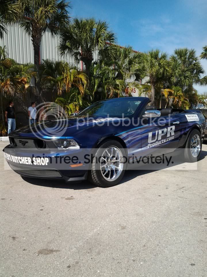

Is the UPr car lowered? Also, both of you are on slicks right? Because on a street tires, LCA angle would help tremendously on a tire otherwise not apt to get great traction
Our car is on UPR Drag Springs. I don't have before and after measurements, but it's about a 3/4" drop. It's on Hoosier drag radials.
^^parade photo... please excuse all of the lettering.
