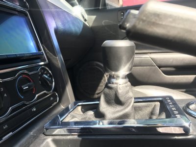

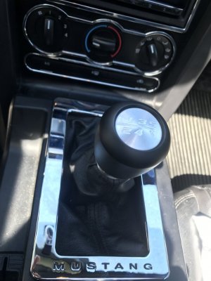

Yep this is a con of a typical short throw shifter but a sufficiently weighted shift knob will make gear engagements easier when used w\ a ST shifter.
I got 1 myself from Raceseng for my Barton (Topology which weighs 1.4 lbs) & it made a big difference IMHO in operation & feel (knob is hefty & I have large hands). Raceseng's stuff is high dollar but is some of the best quality you'll find available.

Really nice shifter knobs, but whew! they are expensive.
Yes they are certainly expensive, but show me another aftermarket weighted shift knob that has the fit, feel & look of an OEM part that flows w\ the car's interior design but provides real weighted functionality as well when used w\ a short throw shifter (or the OEM shifter as well).
This particular Raceseng Topology weighted shift knob w\ OEM shaft thread adapter & shift boot retainer is specifically designed for the Ford 05-09 S197 platform by Raceseng.
The Delrin cover sleeve is what sets the Raceseng Ology Hybrid series apart from the rest as this sleeve makes this knob easily accessible w\ your hand during hot or cold climates...which is a big drawback of a typical weighted shift knob as they retain heat or cold due to their dense metal mass which can make them uncomfortable to handle.
Well worth the price to me.
