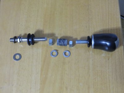

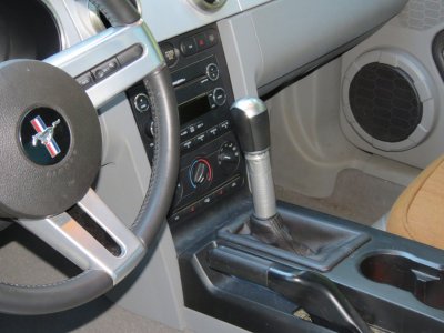

I installed a MGW shifter a couple of years ago. It's a nice piece, though I personally found that even the longest throw setting to be too short and too notchy for me. Just so you know, I'm really a sports car/road course kind of driver so I shift pretty deliberately (you can say 'slow' and it won't bother me). While the new-found precision was nice, the new-found feel was not, and I ended up making my own shift lever extension piece that fixed those downsides without losing the precision. Maybe these pictures will help somebody else.
But I'm about one phone call away from swapping out the MGW - along with the TR3650 that it's connected to and that now-somewhat sloppy link that's between them - for a Magnum XL. Not for the power capability (that's staying right where it is with the FRPP tune), but for the closer 2-3 and 4-5 gear ratio spacings, which in the TR3650 are really too wide to be worth much out on a road course where the corners aren't slow enough for 2nd to be useful and grabbing 5th on the longer straights makes the car fall on its face. Be nice to have nearly 45 mph available in 1st against a 6000 rpm redline, too.
