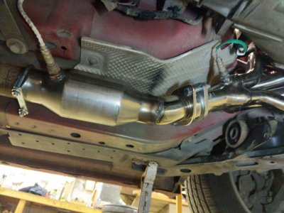

I got a couple off of Amazon. 12" long OA. 2 1/2" IDMVIMG_20191024_191813.jpg MVIMG_20191024_191813.jpg MVIMG_20191024_191813.jpg MVIMG_20191024_192038.jpg . With O2 sensor bung. About $95 shipped. So far so good. I have these between Pypes long tube headers and the stock H-pipe.

Here's what mine looks like. The connecting elbows came from some SS tube scraps I had lying around.

I got a couple off of Amazon. 12" long OA. 2 1/2" IDView attachment 71140 View attachment 71140 View attachment 71140 View attachment 71141 . With O2 sensor bung. About $95 shipped. So far so good. I have these between Pypes long tube headers and the stock H-pipe.
Hi Rick Simons,
Do those cats that you got off Amazon have the metal or ceramic substrate inside? Are you running w\ the rear O2 sensors active & passing emissions as they are shown in the picture? Very interested in your results w\ this setup...……….
If you have a general OBDII scan tool that can access the Onboard Monitor Test data (Mode 6) in your car's PCM, would you look up the B1 & B2 Catalyst Test Rear to Front Switch Ratio & post the results?
I'd highly appreciate any feedback you can give here.

I believe they are ceramic substrate, at least that's what it looks like inside. I have the rear O2 sensors hooked up and functional. Fortunately where I live emissions tests aren't done (yet). I wanted everything functional in case I ever had to have it tested. I read where you could at one time turn the rear sensors off, but when I bought the tuner they (BAMA) told me the ability to turn off the rear sensors went away a few years ago after a federal mandate. Honestly, I prefer the cleaner smelling exhaust and these cats are supposed to support up to 5.9 liters EACH, so I don't think they're costing much power. I can forward the info to you once I get home this weekend.

Will be looking forward to looking at the OBDII monitor test results. As far as Bama goes, I know for a fact that they used to turn the rear O2's off in their tunes w\o asking....even if you told them you are running cats.....wasn't that long ago either (last year). I know 1st hand as I caught them doing it in their tunes that they sent me (still have the tune files & the comms emails saved so can prove it)....had to make a request to them to stop doing that for any tunes that they did for me when I was using their tunes but I don't use them anymore (was told by Bama that they couldn't provide tunes for my Lunati VooDoo #21270700 cams.....). I'm in the same situation as you are concerning emissions testing so I run cats by choice & am in agreement as well concerning the exhaust smell....also why I run cats. But there is more to this than a lot of the aftermarket exhaust manuf's let on....thus why I'm very curious in the data that I asked for from your car's PCM as that monitor test result data will directly correlate w\ your exhaust setup design as well as any other bolt on parts and\or tune files being used in PCM. Good to know also that your car has been tuned as well as having FBO's......helps w\ my little project.
