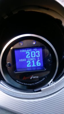

Hello Gentleman, I am messing with my new Aeroforce gauge and have gotten a bit curious with two parameters, coolant temp & head temp.
I know we don't have a coolant sensor and that temp is inferred by checking out the cyl. head temp and doing some math.
So which is the "real" temp and one I should be monitoring on the gauge?
I've seen a hell of a difference in both at random times and they don't seem to change with each other or at the same time, I've also seen them match up. I'd ASSUME it's the head temp. just need to confirm that idea.

I'd like to know this answer, too.
Head temp seems to have a stronger correlation with the oil temp gauge I installed.

I believe the CHT is the only real reading that you get and that coolant temp is just inferred from the CHT. I don't ever recall seeing an actual coolant temp sensor anywhere on the 3V.

Yes, there is definitely no coolant sensor. I guess from logic we can say that the water will be that much degrees cooler than the metal? and the calculation the ECU uses takes that into account? I guess the metal temp is more important than the coolant temp anyway.
I'll throw in another monkey wrench lol... which of these temps decides when the hi-speed fan turns on? (like you get to pick in some tuners before uploading)

The ecu derived coolant temp is what is used for the fan speed. On my SCT-X3 with the VMP tune, I can set the high and low fan thresholds individually, each over a huge range. I can also set the high speed threshold to be lower than the low speed threshold.
The cht typ reads 10-15 deg or so higher than the eng coolant temps.

That makes sense, thank you sir!!

I have noticed the same thing on the Coyote. The Cylinder Head Temp reads 10-20 deg higher than the Coolant temp. FWIW, I monitor the Coolant Temp PID and use an Auto Meter Oil Temp gauge.
