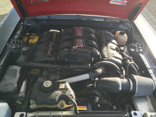

Wow! Impressive improvisation... and cool. Nice job! :snoopy Got any engine pics?

I only have an older picture from just befor the car was finished. Engine bay is tight :)
