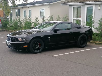

Drag pack (style) wheels with fat rubber, skinny out front
Dropped 35mm on eibach springs
Needs a few other things
Adjustable Panard bar
Stiffer control arms
Maybe a x brace but not that bothered
11s
