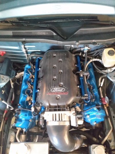

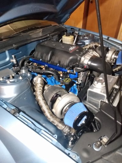

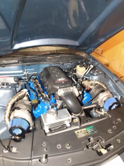

Just completed some major changes to my "fun" Mustang, including:
- converting the S&H "stealt" twin turbo setup to a top-side under-hood setup, including fabication of custom headers and all hot-side piping

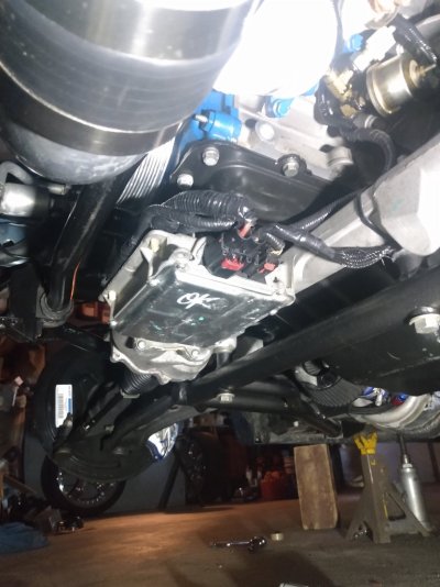

- swap the 4R70W to a built 6R80 and USShift Quick6 remote-display controller and 2014 GT shifter
- converted power steering to use an EPAS rack, eliminating all of the hydraulic power steering parts
- battery relocation to trunk, BEC relocated to battery location

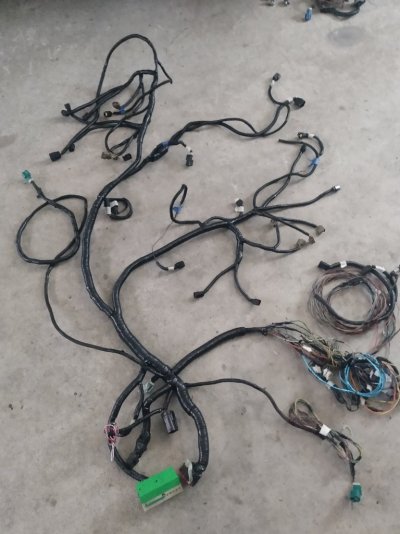

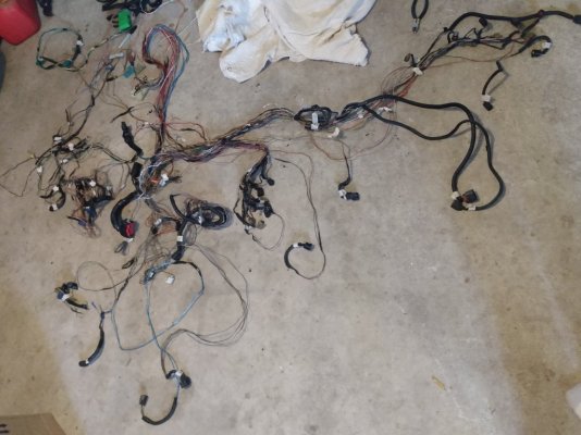

- redo of engine wiring, i.e. a wiring tuck
