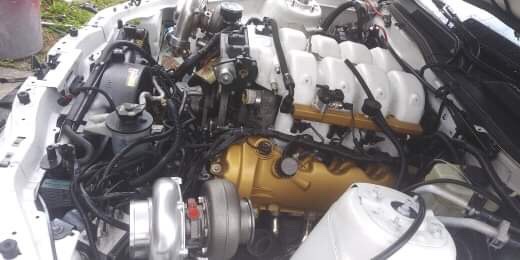

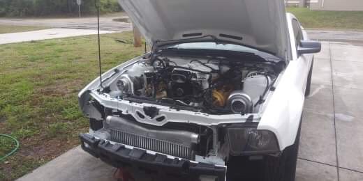

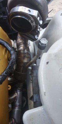

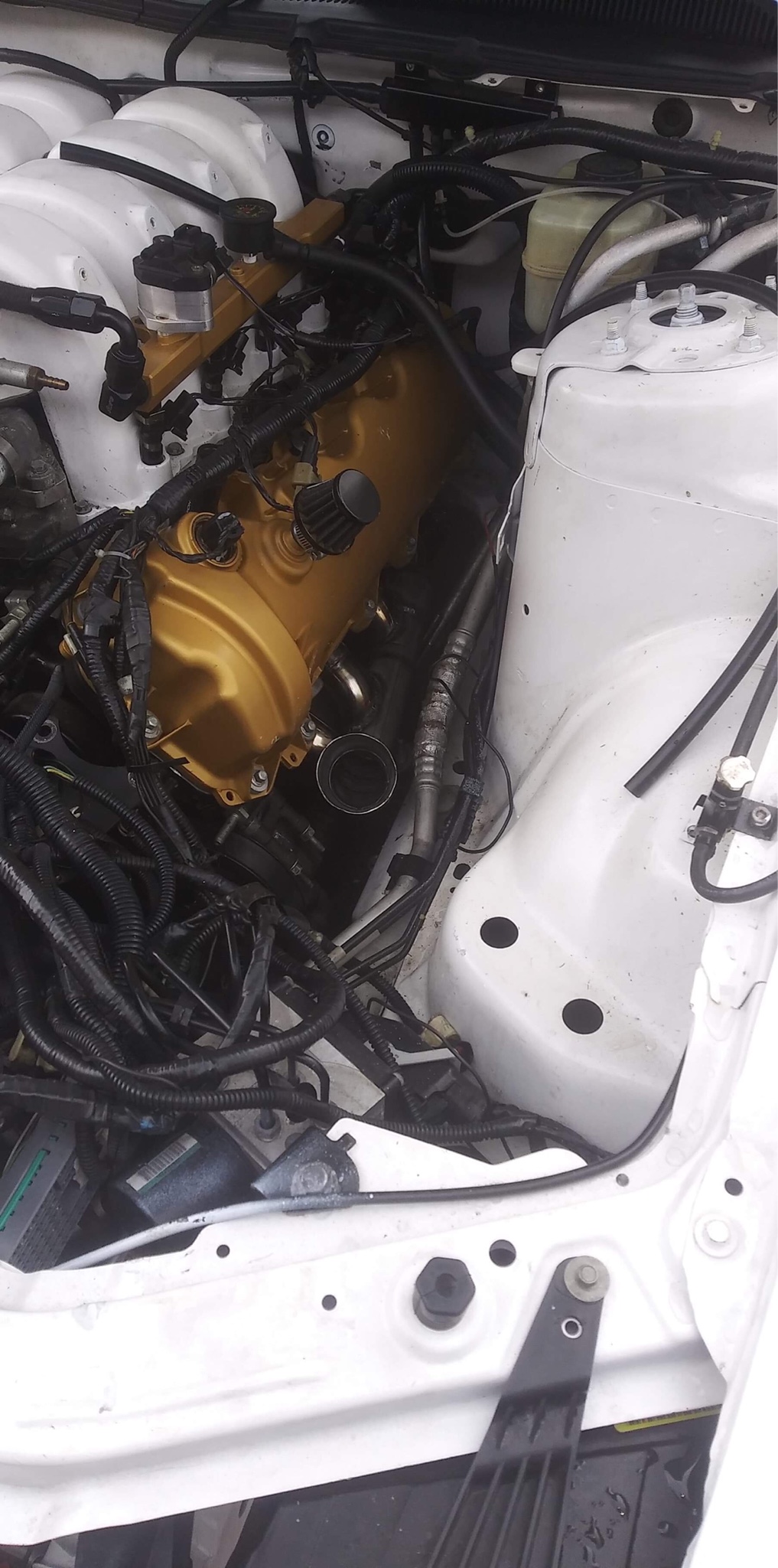

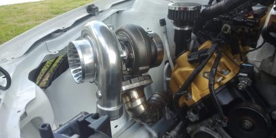

Here are some pics of the beginning of build. As can see in pics the treads tone intercooler is huge and will need to modify bumper to make it work. Also want to give huge shoutout to Jeremy at S&H as he's been very helpful with his knowledge and parts.
TzReddy
Sep 6, 2010
596
Florida

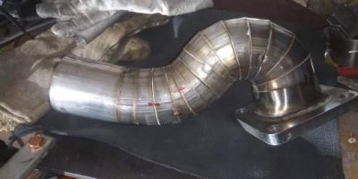

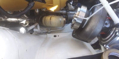

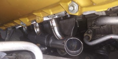

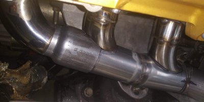

Some updated pics
