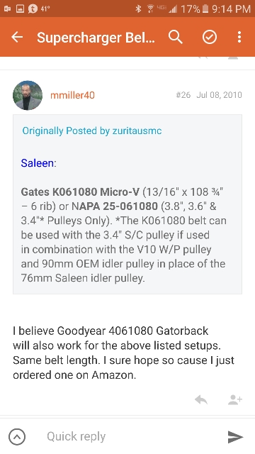

In need of locating the correct serpentine belt size/part# for Saleen VI S/C which has the 3.6" blower pulley. After checking JDM and Brenspeed's website, I located a part number for Gates Micro-V (K061080) which both claim to be the correct part number. However, according to Saleen parts website, it claims that part number is for the 2.875" blower pulley. Needless to say, I have no idea at this point as to which part # nor belt size is the correct one for the Saleen 3.6" pulley. Meanwhile, any feedback/advice would be most welcome.

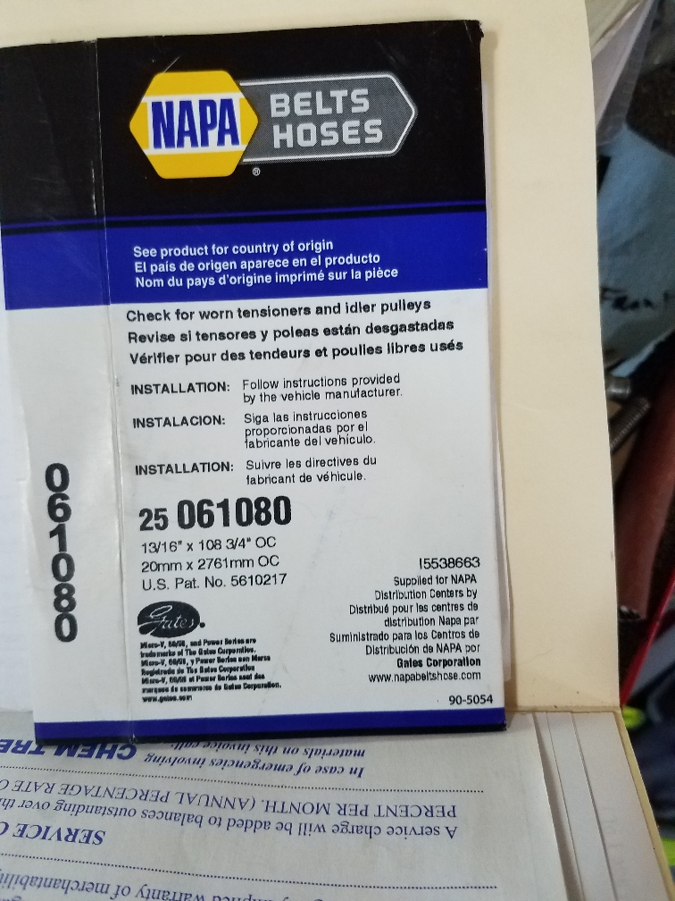

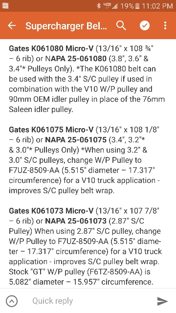

Gates Micro-V K061080 and Napa Micro-V NBH-25061080 appear to be the same belt with effective length of 108.18" and outside circumference of 108.71" with 6 ribs. I'm also considering Gates Micro-V K061098 with effective length of 108.87" and outside circumference of 109.44" with 6 ribs. So my question is, which of these belts would be the correct fitment for the Saleen 3.6" blower pulley, Saleen 76mm idler pulley and Saleen alternator pulley. As for the V10 water pump pulley? I'm not quite certain if that was included in the Saleen VI S/C kit or not, if it wasn't? then it would appear the water pump pulley is OEM/stock :shrug:

Just got off the phone with JimIII from JDM engineering.. Despite confirming the Gates K061080 is the correct belt for Saleen Series VI S/C with 3.6 pulley, Saleen performance parts website claims otherwise by stating their serpentine belt for the 2005-09 Saleen S302E is the correct one with 107.38" for the 3.6" drive pulley. Needless to say, I'm completely stumped as to which is the correct belt according to the Saleen performance website description. Anyhow, I've went ahead and attached a portion of the Saleen website description. Meanwhile, I hope that someone can chime in regarding the Saleen website description claims :shrug:
Serpentine Belt 107.38" 05-09 S302E
$49.99
SKU: 00-1604-C17790
Quantity
Details
These 6-rib 107.38" serpentine belts run quieter, stretch less, and transfer more power than other belts. As they warm up, the composite construction between the cords and rubber compound becomes more efficient at turning your engine's accessories. And by absorbing the shock and vibration transmitted from the crank pulley, the belts can help your harmonic damper to better reduce harmful vibrations.
OEM replacement for 2005-09 S302E (Extreme) and fits and Saleen Series VI, VI.5 Saleen Supercharger system with the 3.6" Supercharger Drive Pulley.

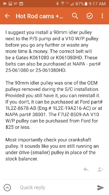

JimIII from JDM engineering recommends swapping out the stock Saleen 76mm idler and tensioner pulleys towards Ford OEM 90mm steel tensioner and idler pulleys along with Gates Micro-V K061080 which is the 108.18" belt. That being said, would you also suggest following JDM's recommendations?

I also asked JimIII from JDM about the larger V10 water pump pulley and MoSaleen idler arm. He said just go with the OEM Ford 90mm idler and 90mm tensioner pulleys along with Gates Micro-V K061080 belt in 108.18"

Just to follow up, it was in fact the Gates K061080 belt in 108.18" that was the correct size/part# which was also the old belt part#.. Went ahead and replaced the Saleen 76mm idler pulley with Ford OEM 90mm idler pulley along with new Gates K061080 belt and also replaced the old belt tensioner with a new Ford OEM one for the time being until able to upgrade to either Thump rrr or American Racing Solutions belt tensioner, as recommended by JimIII at JDM engineering.
