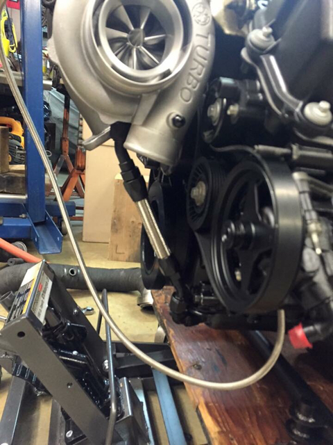

Worst case scenario aside how about the turbo?
Oil fed turbo? How much oil do you think the turbo is using? Does the turbo have a recommended oil viscosity? Maybe the turbo return line isn't supplying enough oil to the motor at higher rpms?

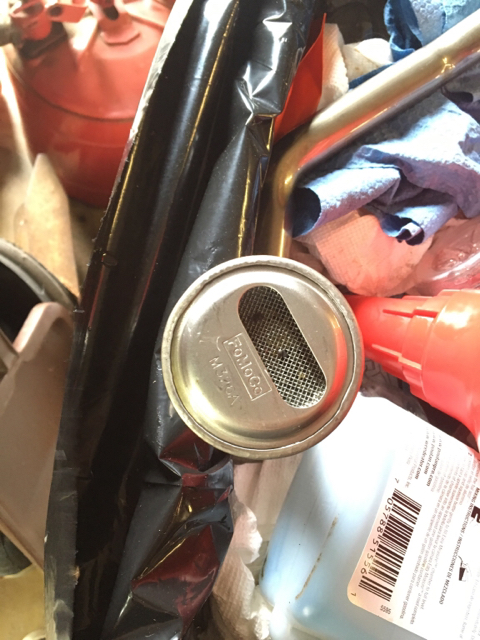

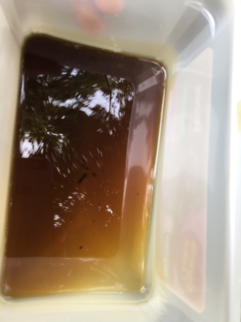

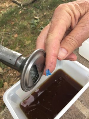

Glad you replied you have come up in some searches online today. So today we went the route of thinking we had something in the pick up. We found this:
We figured we had it so we cleaned pan put in new pickup buttoned it up with fresh oil and filter 10w30 joe fibs driven oil. Took for spin and within 5 minutes we had low oil pressure warning. No noises at this point and we still question the validity of the warning.
Did some light driving and started to push a bit rpm into and and it started all the low idle chain slap type noise. Got it home rigged up gauge was like 20psi pressure!!!

.002" for bearing clearances should be good. The pics look like some rtv squeeze out, nothing major. Is there more that isn't showing up in the pics?
What about your turbo? Do you think it's starving the motor of oil at times?

Have to check the turbo. The drain should good best we can tell it's straight down with a turn at the pan?
