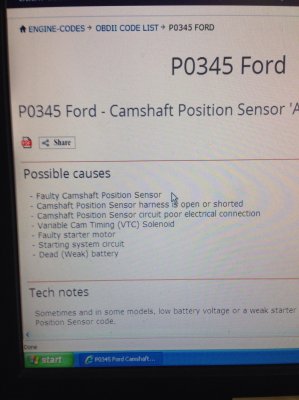

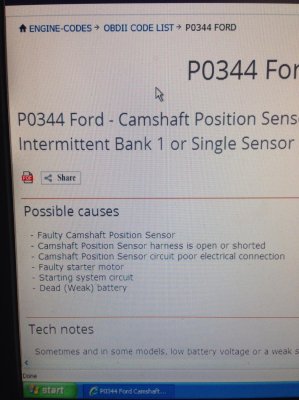

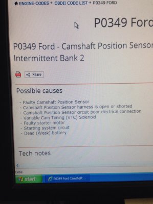

So my car finally runs again and it's throwing 3-4 codes repeatedly. The alternator is pushing out almost 14v so I know it's good, I just replaced the starter because the signal wire didn't have a good connection. I'm running out of ideas and am looking for assistance. The codes are as follows:
P0340
P0344
P0345
P0349(sometimes but not always)
My next step is replacing the cam pos sensors to see if that helps. Other than that, does anyone have any ideas?
