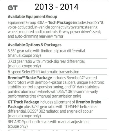

From the Mustang brochure of the days:
And the Track Pack as described above, was only available on 2013-2014 cars.

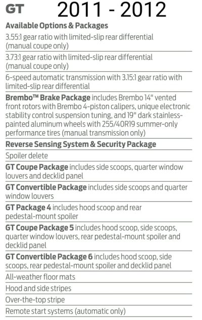

The 2011-2012 cars had the Brembo Pack option, but no Track Pack:
Not necessarily, you can have BBP and add Torsen Diff.
It comes with the Track-Pack, not sure if all Torsen Diffs come with it though.
No, the Torsen was only available as part of the Track Pack, only on manual-transmission coupes.
You could've added the 3.73 ratio, but the differential was a clutch-pack style, not the helical-gear Torsen.

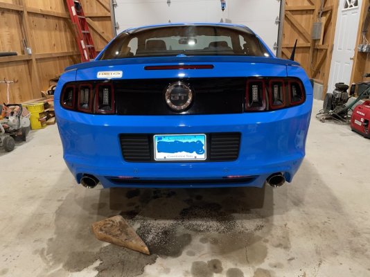

Post a picture of the mufflers
Gabe
Whippled Coyote
Aug 7, 2011
8,467
1,562
Muffler delete pipes with the factory resonators still in place.
By the way, that's not a dent in the resonator, that's the way Ford built them. They're both the same, one is installed upside down and makes that "dent" visible. It's normal.
