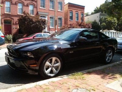

Long story short - bought my 2014 GT (base model, black, 6M) brand new back in summer 2014. I had wanted a Mustang of my own for years and even more so when I heard that Ford was bringing back the 5.0. When I moved from NYC to the DMV area, I was finally able to justify buying a car again.
Here's the car the first week or so that I picked it up:

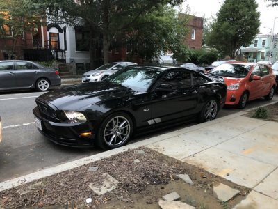

And here's pretty much how it looks currently:
I've done some mods over the years but nothing too crazy. Exterior additions - MMD ducktail spoiler, 19 inch track pack wheels, window tint, and Saleen hash stripes (a friend of mine who really got me into Mustangs years back had these stripes on his black Fox Mustang and I always loved the look). I can appreciate some of the more wild Mustang builds but for my cars, I prefer a mostly stock look with subtle changes/updates.
I've upgraded some suspension components to make the car's stance a little bit more visually appealing, and to make the car handle better. List so far includes Koni orange shocks & struts, Roush lowering springs in front, SR springs in rear, J&M caster camber plates, Whiteline panhard rod, Whiteline rear LCAs, and relocation brackets. I also have Steeda low profile jacking rails, which have been a godsend when wrenching in the garage the last few years.
I added Roush axle backs for better sound, which I had on the car until last year. I loved that sound but eventually got tired of the drone. I tried a set of generic axle backs I found for cheap, went back to stock, and eventually switched to the GT500 ABs. I recently added the LTH over-the-axle pipes and I'm pretty happy with the sound on that setup.

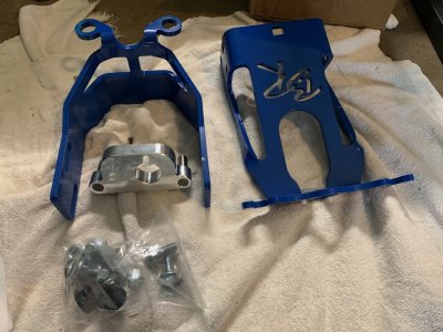

My most recent additions are probably the two things I wish I would have thought to install a few years ago - the Blowfish Racing shifter bracket and the Ford Performance Track Cal.
On the shifter note, I've tried the Barton bracket, the Barton shifter + Barton bracket, the Steeda shifter + Barton bracket, and the stock shifter with a weighted shift knob. I currently have the Blowfish bracket with the stock shifter and the weighted shift knob. This setup has been the best I've experienced so far. The Blowfish setup makes the shifting feel a lot more smooth and the increase in NVH was noticeable at first but not bothersome. It also looks pretty cool on the car but obviously not something you see very often.

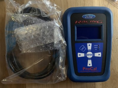

This weekend I added the Ford Performance Track Cal. The install was fairly quick and once I got the car out for a drive, the changes were noticeable. I also dig the lopey cam idle, even if it feels a little bit gimmicky. I finished a video last night with a bit on the install and my first impressions.

All that time, effort and money buying and swapping shifter parts instead of just buying the best damn shifter on the market.
I bought my 2014 Mustang in Augusta, GA which is about 20 miles away from MGW. I drove my new car off the lot, went straight to MGW to pick up my new shifter, returned to the dealership to load up the car on my trailer, and then towed it home to Orlando. I swapped the shifter out 2 days later so I only had less than 100 miles on the stock shifter. I was already sold on MGW based on how it worked on my 2009 Bullitt.
You can keep your Barton, your weighted shift knob and you can especially keep your Blowfish bracket (I was one of the original 100 buyers). Screw that vibrating POS. I had it on my 2009 for all of 2 weeks before removing it and reselling it. I crack up every time I read another version of somebody unhappy with their shifter but they think the MGW is too expensive.

+1 on the MGW
As Brian noted, they are the best, by far, for the S197 w/MT82
I had the Barton and it vibrated, added the BlowFish later and it vibrated more. Scrapped all that and added an MGW Race Spec shifter that had the same or better NVH than stock and shifted better than any shifter I've used on the MT82.

I never said anything about the MGW being too expensive (or anything at all about the MGW). I did say that I'm happy with my current setup though.
Part of the reason I bought the Blowfish bracket is because the factory shifter bracket bolts sheered off on my car last year. Even though I had that fixed by Ford, I still wanted to remove that failure point. The fact that I enjoy the way the car feels with that bracket is an added bonus.
I don't consider the time/money spent on trying different shifter setups a waste. I like to try things out for myself and decide. I sold the Barton shifter and bracket and recouped most of my money spent. If I ever drive a car with an MGW and I like it better than my current setup, perhaps I'll consider that option.

I didn't mind the Barton at first but eventually got tired of how notchy it was and decided to try other setups. I sold the Barton before I ever bought the Blowfish bracket. Maybe I'll eventually give the MGW a try but for now, I'm happy with the combination I have.

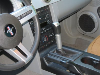

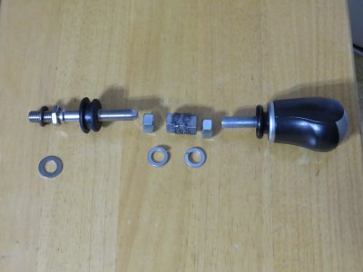

In general, shortening up the shift throws increases whatever tendency for notchiness already exists.
For my '08 GT I went straight to MGW and started out at its longest throw (because I had a fair idea about this particular downside).
Shift action was way too notchy for me (I don't ever shift like a drag racer), so I added a shift lever extension to lengthen the throw (and improve the mechanical advantage). My car was a dual purpose DD/track toy at the time, so I wasn't much concerned about appearance. Worked just fine, nice easy throws, closer to the steering wheel, and the extra throw was essentially unnoticeable.
