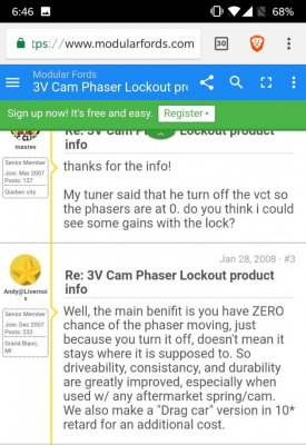

Not sure who you talked to at Livernois, but last I talked to them they still made them (it's been a few years now).
Here's a screen shot from modularfords with Andy at Livernois talking about them. You probably have to specially request them.

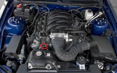

you dont have to crack open the vale covers. there should be one per side on the front of the timing cover at the bottom edge of the valve cover where the two meet. if you are missing one or one is unplugged, that bank will be dead
sportinawoody
Aug 10, 2008
2,376
36
Piedmont area , N.C.
the one that can be seen is circled. the other is hidden by the intake tube on the other bank. it only has 1 wire, and that wire with key on should be hot with 12 volts. if it isnt hot with key on and both are plugged up, then you need to find the source of voltage loss
