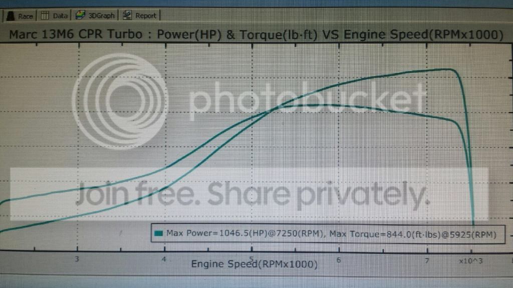

Plans are for an auto w brake so we went big on the backside. Fueling showed the turbo showed the compressor juuuuust started getting efficient around 15psi. Needs another 200rwhp to be happy. 1045rwhp on 16psi ain't too shabby. Pretty happy with it. Thru the air filter and full exhaust out the back :clap:

But that is making some pretty good steam right there! Is the torque normally down by that sort of margin on a turbo car? Like in this case it is down about 200 or so, is that a characteristic of a turbo car or a FI car in general?

what does that dyno sheet trap??

Hey hey, my job was done correctly. Getting it down the track is their job lol. Auto is next. He'll play for a bit or until he breaks it. But he's in and out of the country so it might be a bit

Depends. On a turbo that spools sooner, you can see maybe a bit higher torque number sooner in the rpm. So the peak numbers will be closer. But it's not really a bad thing either. This thing is making power clear over the 65-6800 other kits peak. If we move back in rpm on the graph, hp would be lower, and torque would be higher. And you'd see less of a spread. Torque dropping and hp climbing is normal. Sure the spread would be even higher if he took it to its actual max rpm. But it was limited to 7600 in the software, and that's where he took it. Car will easily need 8k shift points. anywYs, spread is not necessarily a bad thing. Look at a hellion single. More torque than Hp. That's bad mkay? Lol
Hope that makes sense.
