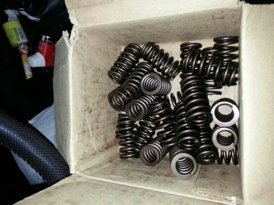

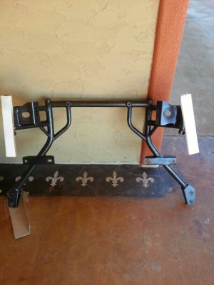

BMR k member and livernoin springs are here
Sent from my SPH-L900 using Tapatalk
