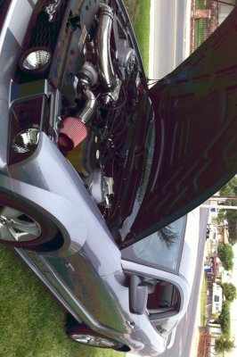

So I'm almost done with the boost brother install. Well the install is done just need to finish the tuning.
Ok keep in mind that the boost brother is only for Manuel trans car. ONLY!! And I installed it on a 06 auto car. So of course we had to take the car to my buddy's shop and get some pipes made.
Let's start with con's on the kit. 1 they never said it was for Manuel cars only. 2 the maf mounting flange had some metal in the way that didn't allow the Maf to fully seat. Just took a eat file to fix it no big deal. 3 no instructions at all. We had to use turbonectic online instruction. Again no big deal. 4 the oil tee to feed the turbo wouldn't tighten up as others do. It will bottom out and still leak. We used this liquid yellow stuff from home depot to seal it. Again no big deal. 5. The hood just barly closes. It actually touches the intake tube. The tube are huge. 6 they didn't send any vacuum lines to work the waste gate. 7. There is some brackets that I don't know were they go and didn't use. Haha.
Pros.
It's super cheap. " price"
Don't have to buy a pmas or MAFia cause of the big tube.
Spools real fast.
Nice finish.
All the pipes that I did use fit just fine. Again I didn't use all of them cause we custom made some
Comes with air filter. On3 has u buy ur own but no big deal.
Has a place for a wideband.
Has a degas bottle relocater for those who have on3 u know the lower degas bottle hose runs pretty much against the trubo.
Here is a pix of the car

Thanks for the update!
The issue with the intake tube touching the hood - could that be because of the kit being for a manual? What did you use for vacuum lines and what is a degas bottle?

The guy that did the original design at turbonetics had zero knowledge on maf location design, and the one that copied it, even less.

@ignatwski the degas bottle is the coolant bottle. And not the tube is jut to dam big. And like lito said it's bigger than it is. They made it even bigger before the maf to install this steel mesh to help the maf sensor read more accurate but don't know it's a good thing at this point. Oem ones work great. Te guy who owns this car was thinking about buying another hood anyways. This one still closes but the hood touches it. It will be the case even if u had a Manuel trans. We might just make a new smaller tube and either use a pmas or mafia. Other than that so far so good.
I would just recommend on3 because it all fits but u do have to deal with the oil filter relocater kit. And use as much wrap as u can for noise control.
Someone brought up twin set up. I might just change to that later. Who knows haven't decided yet. Any inputs are welcome.
