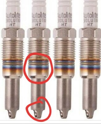

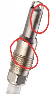

Here are the visual differences I mentioned on the shell attachment and ground strap.
Old
New
It appears the new design the electrode shell gets installed and then has some kind of heat weld vice a mechanical crimp fit inside.
