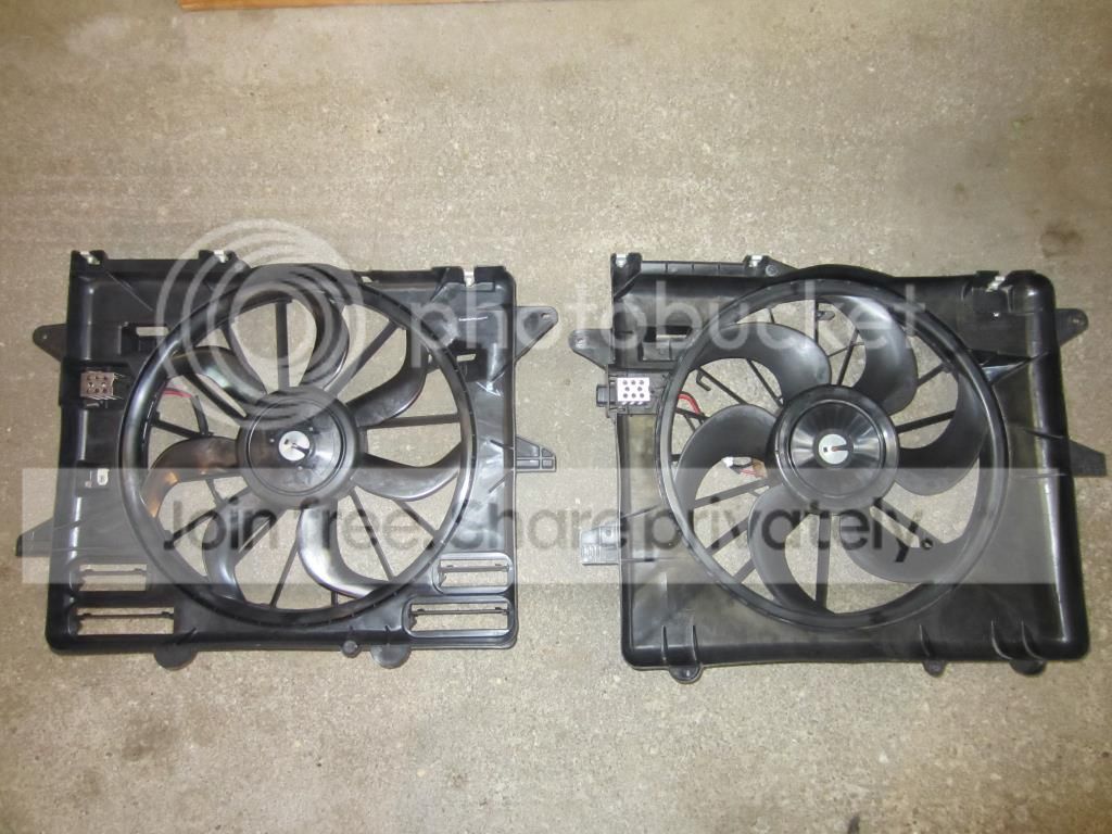

Not exactly what you are asking, but possible an alternative. In my build (Vortech air-to-water) I installed an AFCO radiator (a good 1"+ wider than OEM rad) and replaced my OEM fan with a Ford Racing Fan, part number M-8C607-SVT.
Ford Racing left, OEM Right:

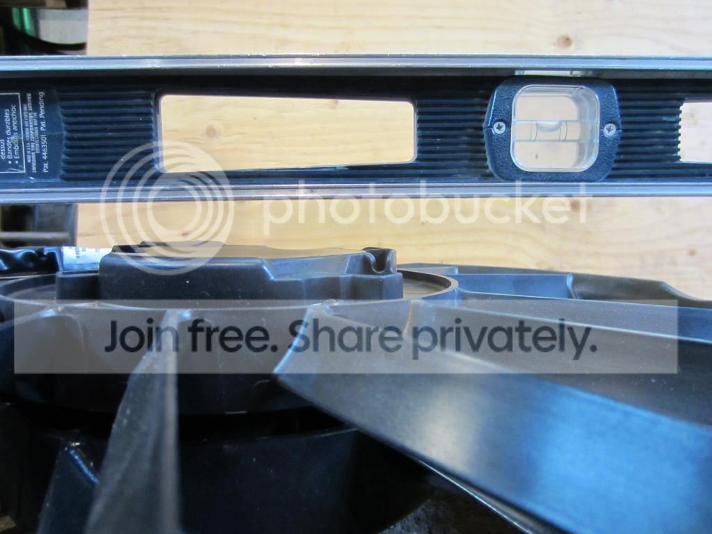

The picture below shows how much narrower the Ford Racing fan is than the OEM fan. Level placed on top of OEM motor housing and shown above Ford Racing fan.

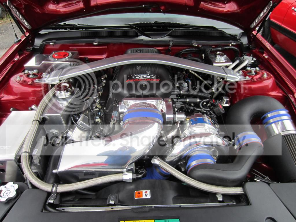

And with the charge cooler it is tight but everything does fit. I assume your build is air-to-air, I can't see the tubing being wider than the charge cooler?
Fosters
Sep 20, 2013
210
That's a pretty decent difference, and for the price, I might just have to pick one of them up, thanks for the pics! I'll get some pics tonight, it definitely is tight in there...
