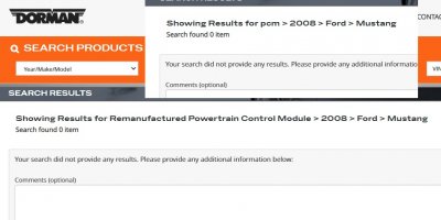

Yes, well .... I considered that but the service writer assured me it was "Domain" and I can't find any info on such a company servicing auto pcm's. The Dorman site returned the results displayed below. Considering a different route even yet but still undecided. I will post up my final course of action here. This one is still unresolved. thanks to all who have responded so far.dorman pcm2.jpg
