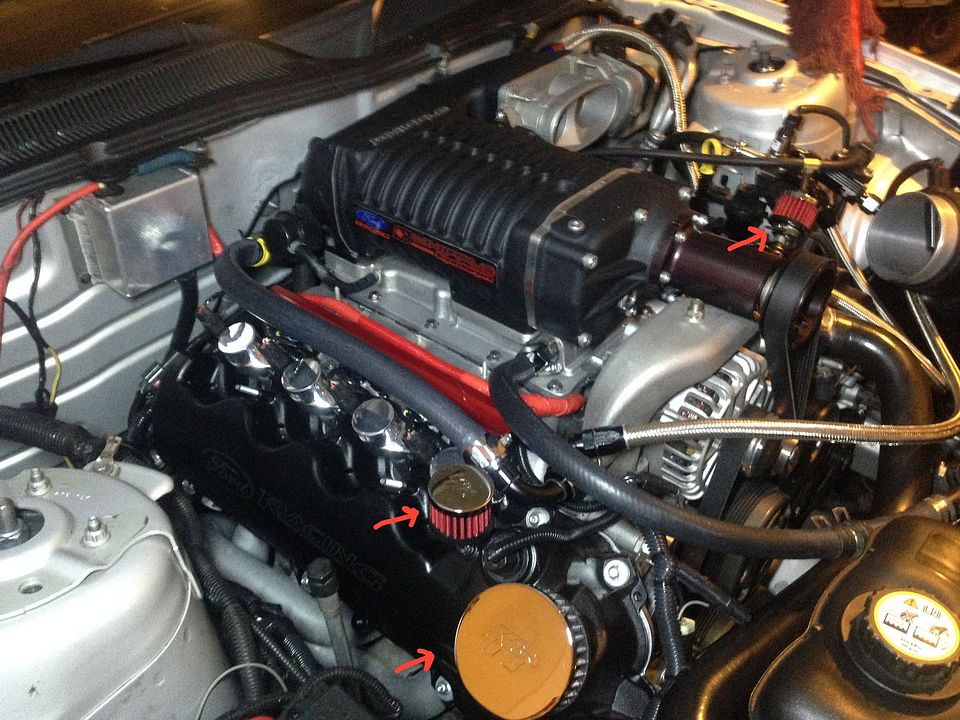

07 Boss
Jan 25, 2009
4,300
1,417
Sin City
Or you can switch to breathers and vent it to the atmosphere instead of running it back through your engine. If you have oil in your intake, your charge motion plates are pretty gummed up too. I've always run breathers on my builds just because I want just air and gas going through my intake. And they just neaten up the engine bay a bit by getting rid of the hoses.
Below you will see your standard 3-breather set up I use in place of the PCV system.

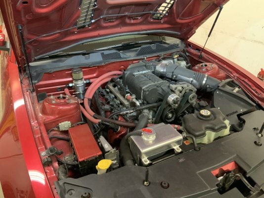

Midlife Crises
Jul 20, 2019
2,364
1,900
Fairbanks, Alaska
Here is another variation of the engine ventilation system similar to what 07 Boss described. Both valve covers are connect to a single, vented catch can with 3/4” hose. There is no PCV and no connection to the air induction system at all. After I found oil in the intercooler under the blower, this is how I “fixed” it. I have no oil in my intake and my spark plugs stay cleaner, longer. Unless I stain them with obtain booster.

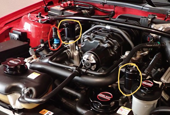

Well.. which is it guys?
Mar 21, 2026
102
181
Midwest
I have catch cans on both the driver's and passenger side, even though the passenger side is the most important side on this engine. The yellow circles are the two catch cans, and the red circle is the PCV valve(brand new last month). These catch cans work and are a must-have for good engine care.
