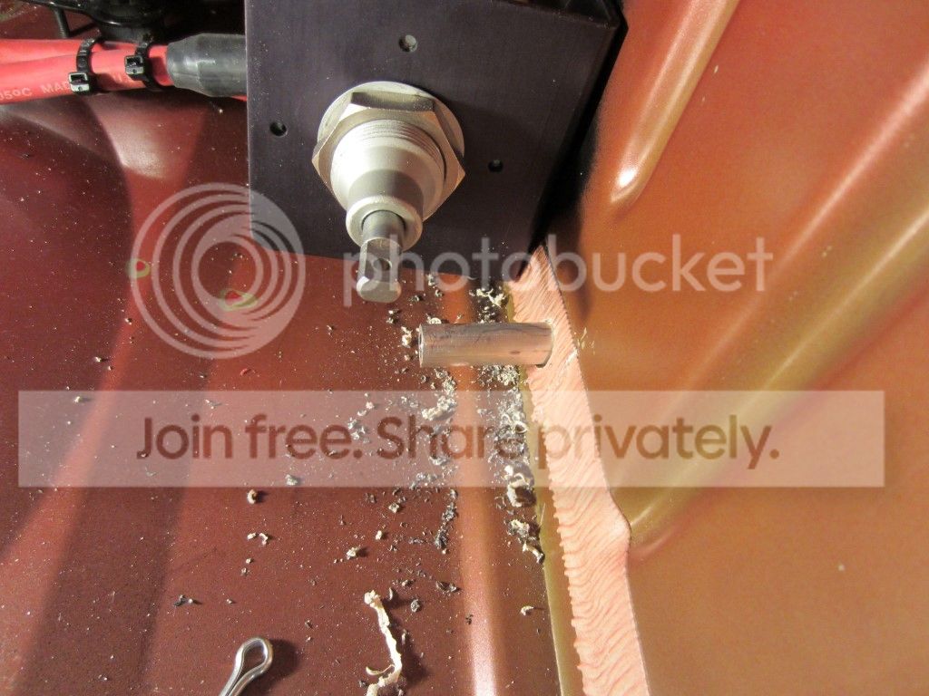

Placed a level to span the trunk floor and the ground. Measured from the level to the trunk floor and to the ground to determine the locations for the holes in the back panel and bumper cover. Marked and drilled 1/8 pilot holes in the back panel and bumper cover.
Placed a trouble light inside the trunk and took a peak through the hole in the bumper cover and voila I see the light. Slipped a welding rod through the two holes and it looks like my alignment should be good to go.
Drilled the back panel and the bumper cover with a step bit to just over ½” and trial fitted the push off rod.
A significant amount of adjusting (grinding) needs to be done to the back panel hole as the disconnect switch swings in an arc and as well the shaft moves in and out as the switch is disengaged/engaged.

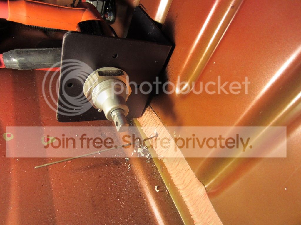

Battery Disconnect Switch - Continued
Trial engaged and disengaged the disconnect switch marking with a felt pen, adjusting the back panel hole with a Dremel and carbide burr double cut bit until the rod would move freely without binding.
This is the hole I ended up with.
Splashed on a little flat black primer to protect the bare metal.
Marked the travel between engaged and disengaged on the push pull rod and determined the 18” rod needed to be cut down to approximately 7-3/4”. Cut the rod with a 6” chop saw, punched and drilled the cut end about 1-1/4” deep with a 1/8” then a ¼” bit (should have used a 17/64” bit for use with a 5/16-18 tap but I did not have one). Using a 5/16-18 tap tapped the hole and installed the 5/16 set screw, jam nut and “T” handle. Finished it off by giving it a quick buff.
Will install the switch tomorrow when the primer dries.

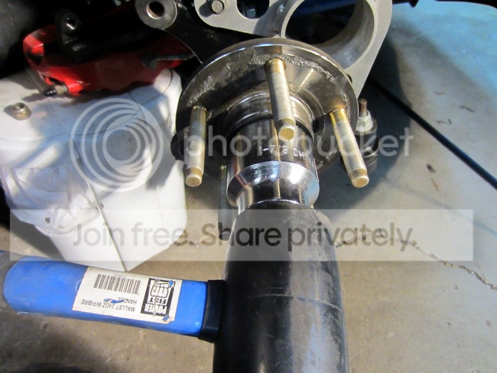

New dust caps, part number F1VY-1N135-A were installed using a 1-7/8” socket and a rubber mallet.
Baer brake rotors were slipped on and held in place with three open-ended lug nuts.
Brake caliper anchor plates were installed and the mounting bolts tightened to 85 ft-lbs with an 15mm socket after applying a little medium strength Loctite on the threads.
Trail fitting Vossen CV3R (20 x 9 +32.5) in Graphite finish for caliper clearance. No issues with Baer 6P calipers or with the TPMS valve stems.
