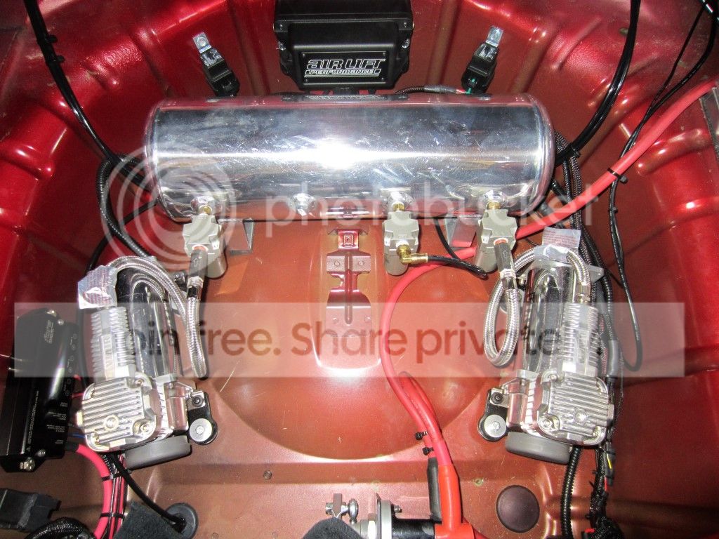

Upgrade is pretty straight forward swap the old manifold and harness for the new ones. I have been tinkering with the install when it has been warm enough to work in the garage.
Disconnected the air lines at the manifold, removed the 2V manifold, first power/compressor wiring harness, controller cable to the console and replaced them with similar 3P components. My existing 2V second compressor “trigger” connection pluged directly into the new 3P harness.
2V manifold removed.
Installed the 3P manifold, power/compressor harness and routed the controller harness to the center console. I reused all of the existing air lines except for the line from the tank. A fresh square cut was made to each line before pushing them into the 3P manifold.
New 3P Controller currently unpowered.
Installation complete. Once the car is back on the ground I will re-calibrate and configure the system.
