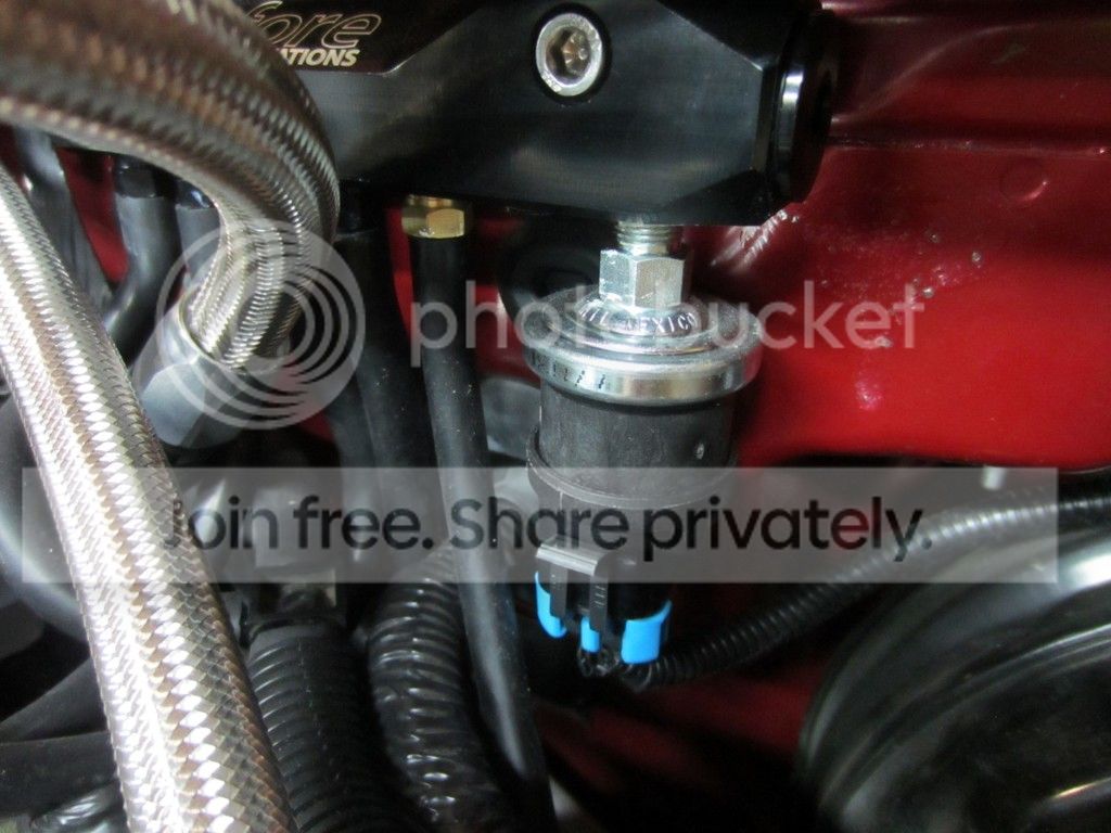

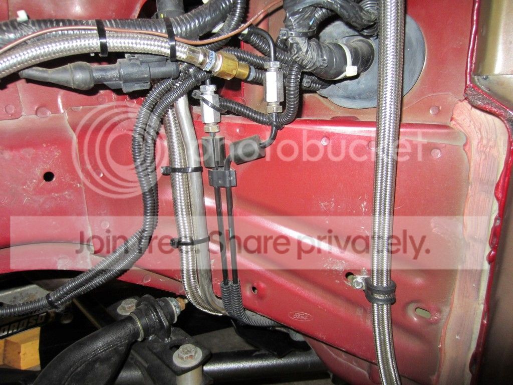

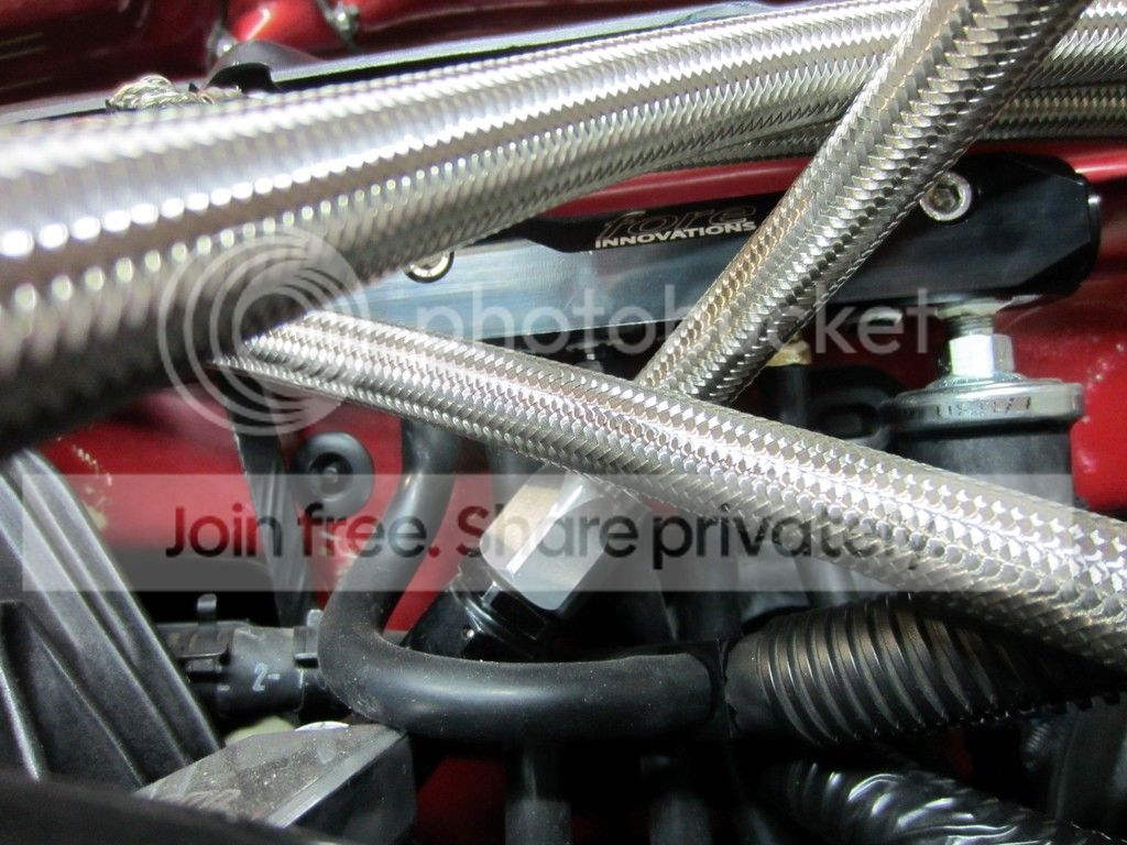

Finally completed the install of a Fore Innovations Vacuum/Boost manifold. Was interesting as things are pretty tight in the engine bay/firewall. Used the manifold for one vacuum/boost source for:
• TurboXS and Vortech Blow Off Valves
• Fuel Rail Pressure Switch
• Auto Meter Vacuum Boost Gauge Sending Unit
• Aeromotive Fuel Pressure Regulator
• Honeywell Pressure Switch
Manifold hidden on the firewall.
Honeywell Pressure Switch – activates the second fuel pump via the FC3 controller under boost.

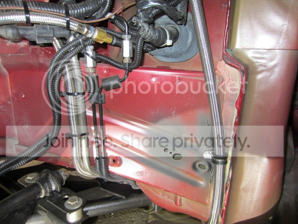

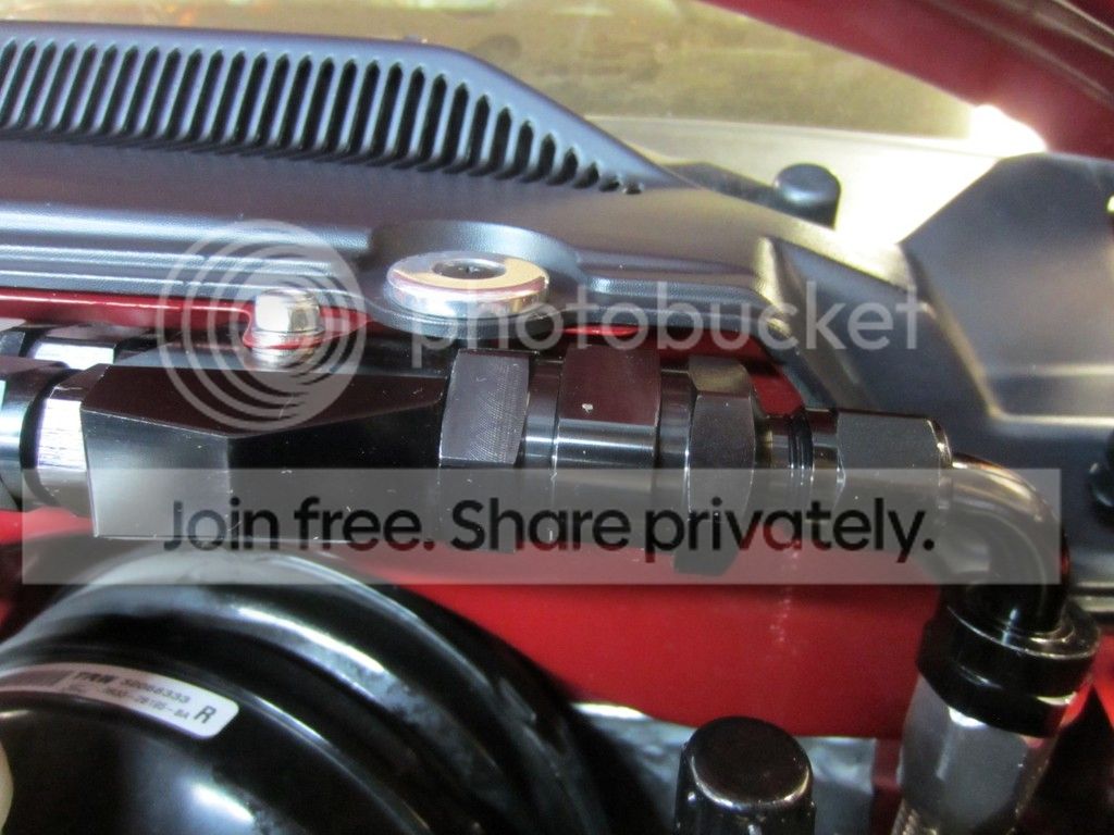

Turing to the fuel system I removed the OEM hard line from the filter to the frame rail and the Russel 8AN line from the frame rail to the Y-Block. These lines were replaced with a Fore Innovations FCV Check Valve and an 8AN line to the new fuel filter. Also roughed in an 6AN return to the tank from the Aeromotive Pressure Regulator.
FCV Check Valve

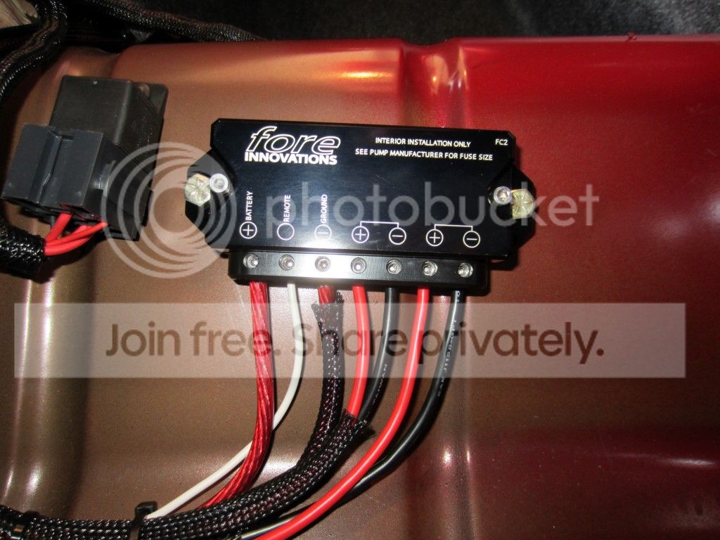

Started by disconnecting the battery and pulling the Fuel Pump Relay from position 21 in the BEC. Removed the plastic panels from the trunk, interior and passenger fender to remove the GT500 harness. Removed the second FPDM and the relay.
I had previously competed the under hood work for the return style system. I added a Y-Block feed from the OEM steel lines via a Russell adapter, a feed to the front of the fuel rails from the Y-Block and a return from the rear of each rail to a fuel pressure regulator. The exiting return line port was blocked at this point.

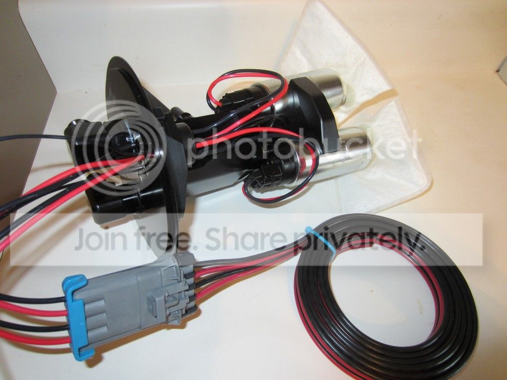

Fore hat, harness with Walbro pumps.

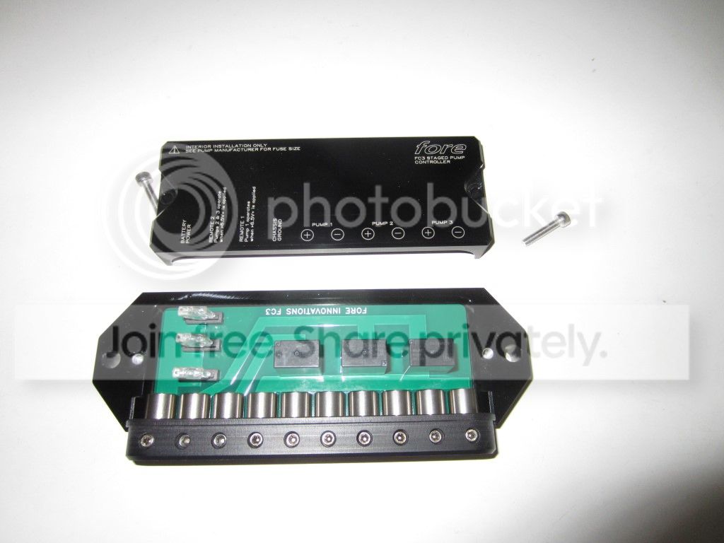

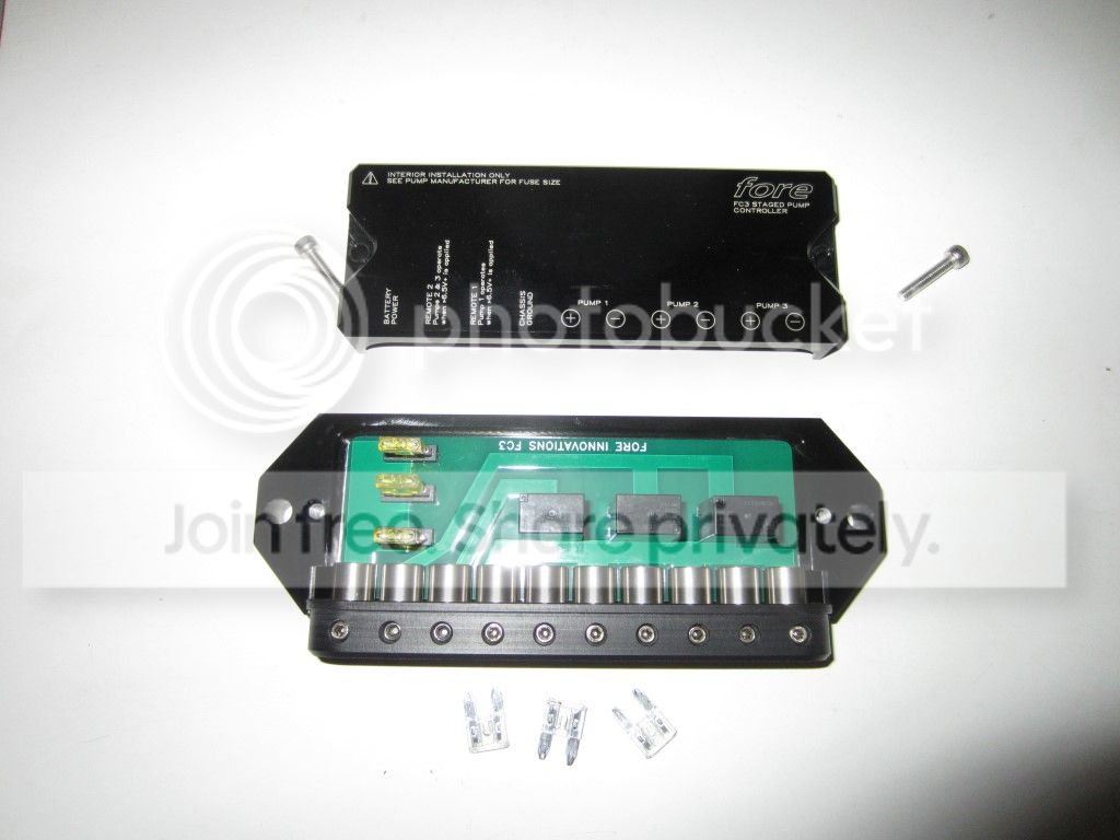

I original acquired a Fore Innovations FC2 controller without realizing that with the FC2 Controller both pumps would run constantly even when only one pump was required. Running both pumps 100% of the time would heat the fuel obviously more than required and I decided to replace the FC2 Controller with an FC3 Staged Controller and Honeywell Pressure Switch. With the FC3 Controller and pressure switch the second pump would be activated when boost exceeds 5 psi.
Original FC2 Controller.
Removed the two cap screws securing the cover of the FC3 Controller with 3mm Allen wrench.
Pulled the three 25AMP (white) fuses and replaced them with 20AMP (yellow) fuses appropriate for my Walbro GSS432 pumps.

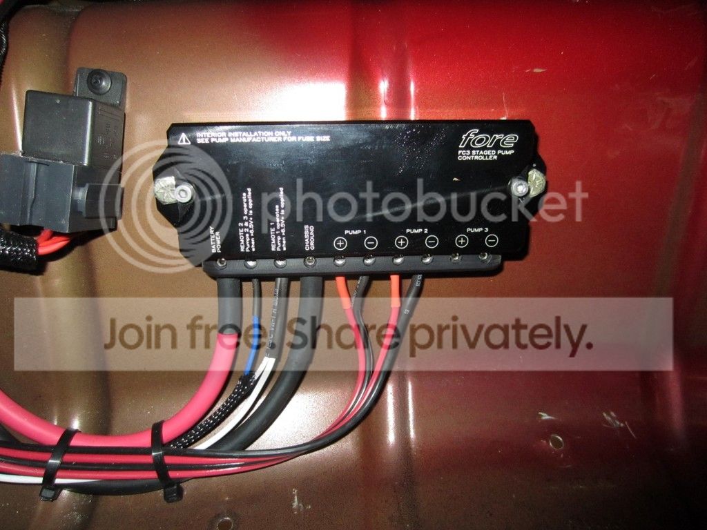

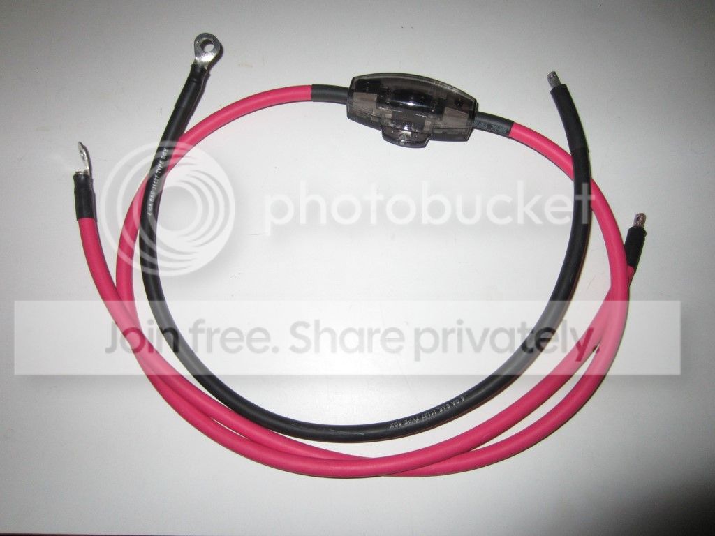

Determined the routing, measured lengths, cut and “tinned” the ends according to the Fore Innovations instructions of the 4 gauge chassis ground and power cables.
FC3 Controller mounted.
Ran the power cables for the pumps to the Fore hat. Cable length was perfect from my FC3 mounting location.
GT500 pump removed, fuel level sender transferred over to the Fore pump and Fore pump slipped in after placing a little oil on a new O-Ring.

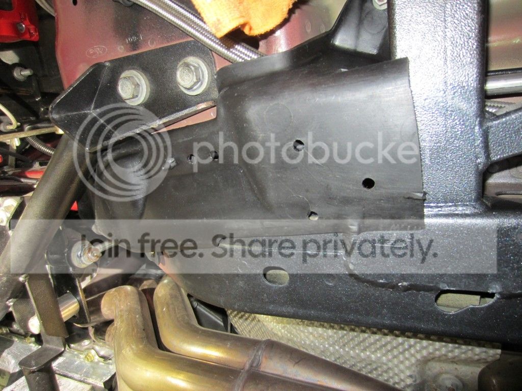

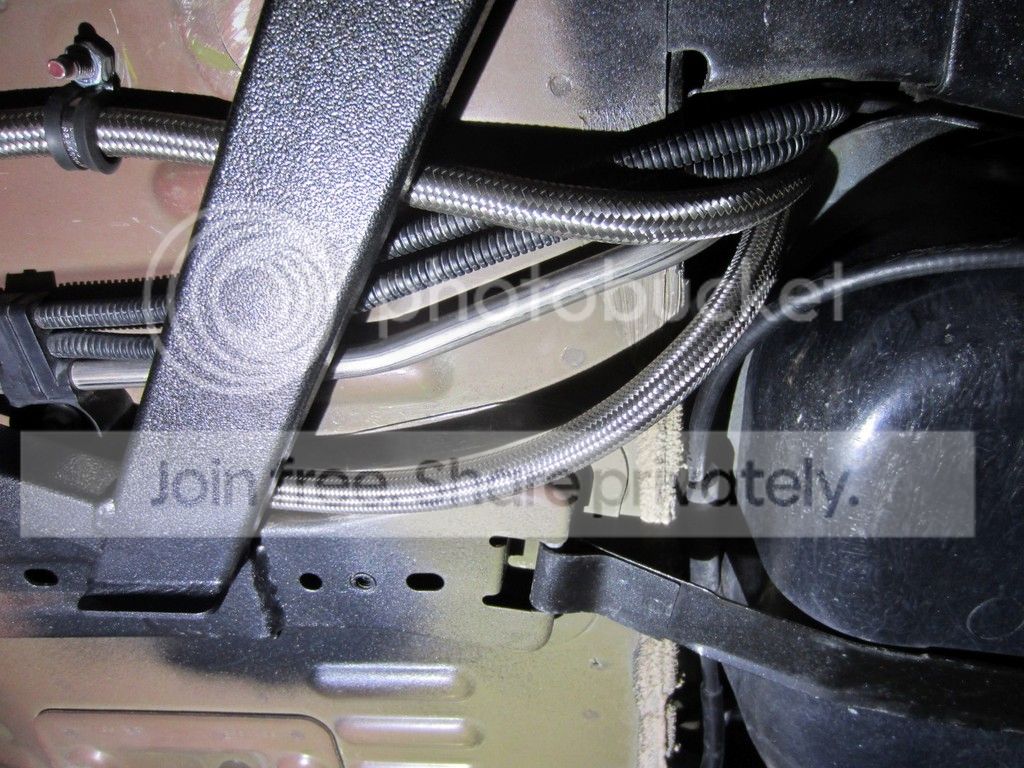

Ran the supply line almost straight down and then back to the fuel filter. Under the car I removed the OEM fuel lines and followed the original OEM path back to the tank. Had to cut the OEM rear line from the filter to the tank because some clown welded in sub frame connectors that were in the way.

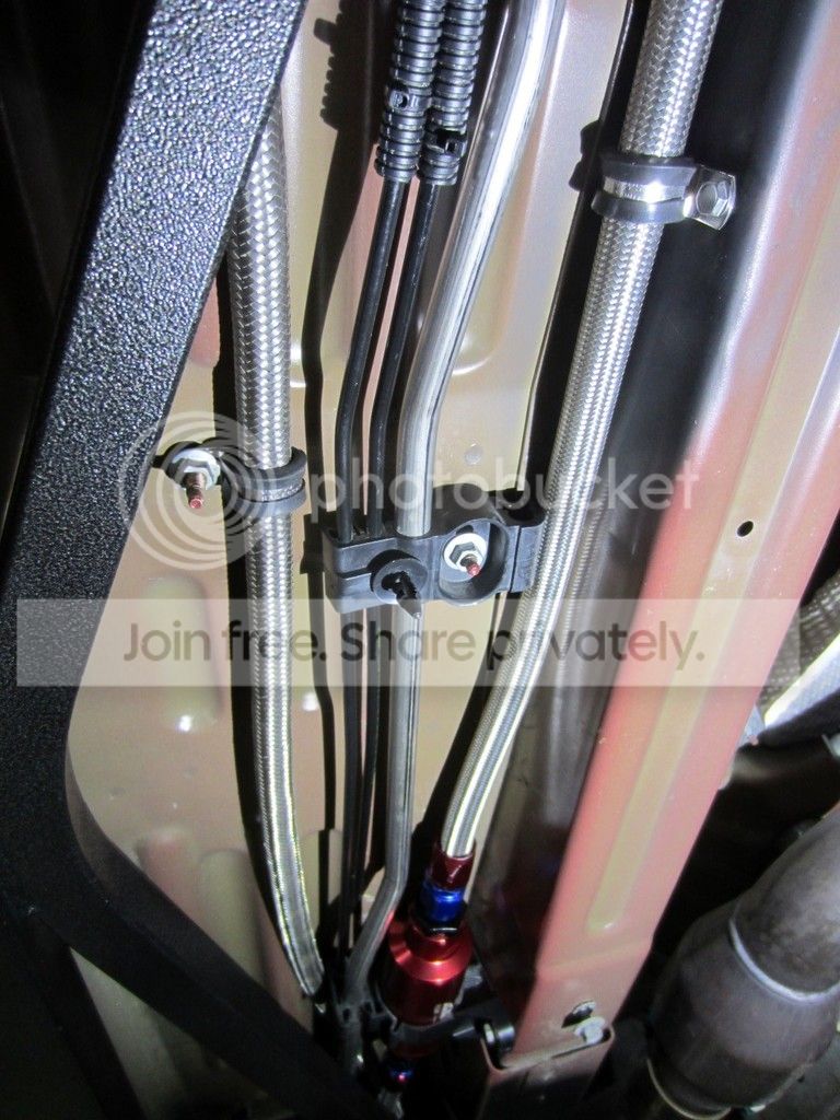

Added the return line following the OEM fuel line path.

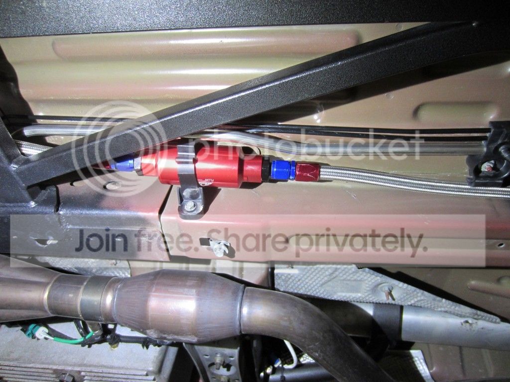

Used the OEM location and mount for the new fuel filter.
Secured the supply and return lines with Adel clamps as required under the car.
Reinstalled the front and rear plastic panels.
8AN supply and return lines heading up to the pumps. Getting the lines with fittings installed feed up and connected is definitely a two person job.
Lines attached at the pump.

As always, very nice work Scott! Which fuel filter is that you're running?
Thanks Kyle, it was a bit of a struggle to get the 8AN lines pushed up with fittings on them. I wrapped them in tape but the finish on the fittings took a beating before I was done. Filter is Aeromotive part number 12301. I bought the filter and an Aeromotive Pressure Regulator from a forum member years ago. I would have jumped at your Fore Filter but the Aeromotive one fit so nicely in the OEM filter mount.

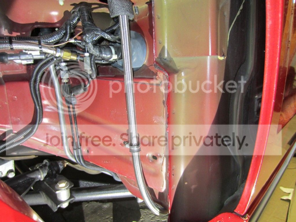

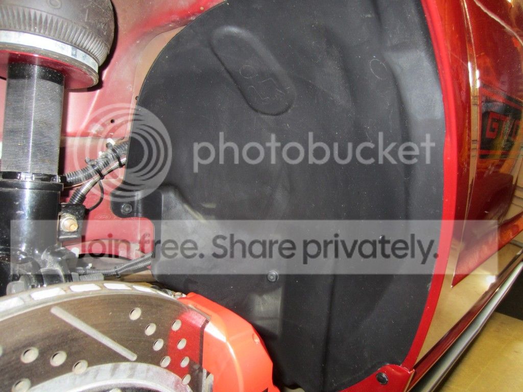

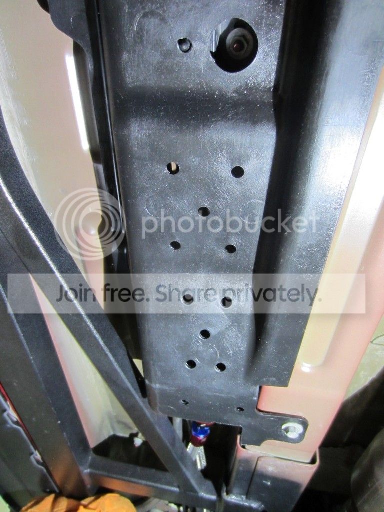

Had to make a slight adjustment in the supply line routing as that straight down approach did not allow the plastic splash panel to fit properly.
Old routing.
New routing with the line moved over a few inches.
Rear splash panel fits like a glove.

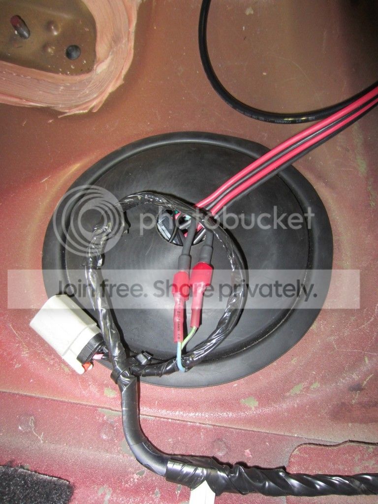

Cover, power harness and sender wires installed. Yet to test the sender to see if the wires need to be reversed.

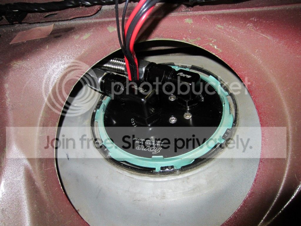

Sender would not work period.
Dropped the tank this time to pull the pump module and I will never do this job again without dropping the tank as it made it much easier to re and re the pump.
Turns out the metal rod had slipped out of the sender body. Clicked it back in, reinstalled the pump and viola we have a functioning fuel level sender.
