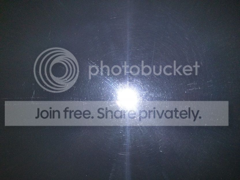

I think this thread has me sold on Polish Angel. My question is how abrasive is the primer? Car is a black 2014 with what i would call some light scratches/swirls and water spots. Will i need to compound the car first or will the primer remove everything? Here's a quick cellphone pic
2011/5.0
Dec 28, 2009
955
22
Iowa
Probably depends on the buffer and pad size you choose. I just finished my dd focus with the viking coat for winter has some pretty nice gloss also
