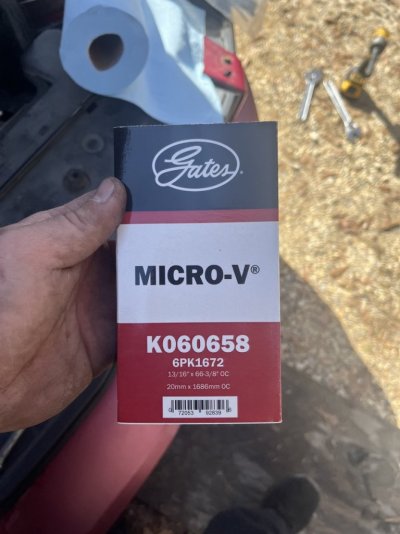

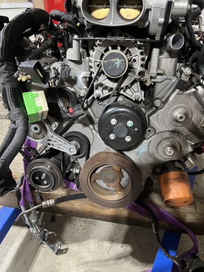

Thanks to discussions in this and other forums, and some learning curves on my own (3 steps forward 2 back, etc.) I am close to installing my motor by this weekend. For this post I wanted to say thanks for the power steering pump delete and much shorter belt advice. Works slick. But after purchasing the suggested belt (AutoZone 650 K6) I had to find a bit longer belt also purchased at AutoZone… 665 K6. My car is an 05 but the engine is an 07 and the AC pump is somewhat different. Not sure if that was the difference on my car but the new belt works.

An idler pulley to the left of the WP with a longer belt would solve that.
Just worried about the belt wrap around that H2O pump.
Agree. The easiest solution is to reinstall a grooved idler pulley and route a longer belt (Gates K060870) around it.

Now y’all got me thinking. I’ll try this and if it doesn’t workl I’ll go with the other pulley/belt configuration. Researching electric water pump. Thanks!
