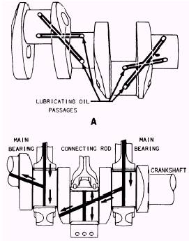

Interesting how the number #3 rod bearings look like normal wear, but #7 is completely trashed. They are on the same journal. Both rods on that journal share the same oil supply circuit right? (might be wrong here) But, I would be looking for some kind of blockage/restriction in the oil circuit supplying oil to the #7 rod. Also on #4 too.
I don't remember off the top of my head but I do believe that they share the same oil supply. I'm curious why #7 is trashed but #3 looks fairly good as well.
If I am understanding you correctly by oil supply circuit you are talking about the holes on the crank journals that feed oil into the bearings? How would I check to see if there is blockage outside of visual looking or is that the only way to do so?
Yes, this is what I was referring to. They sell little brushes to pass through the oil passages to clean them when assembling an engine. I suppose you could use compressed air in the passages/circuits as well.
Example of a typical crank oil circuit. (Photo not specific to 5.0 coyote)
Nice! Thanks for the info! I might just take a look into them and try and clean the crank and reuse it like webber did.
