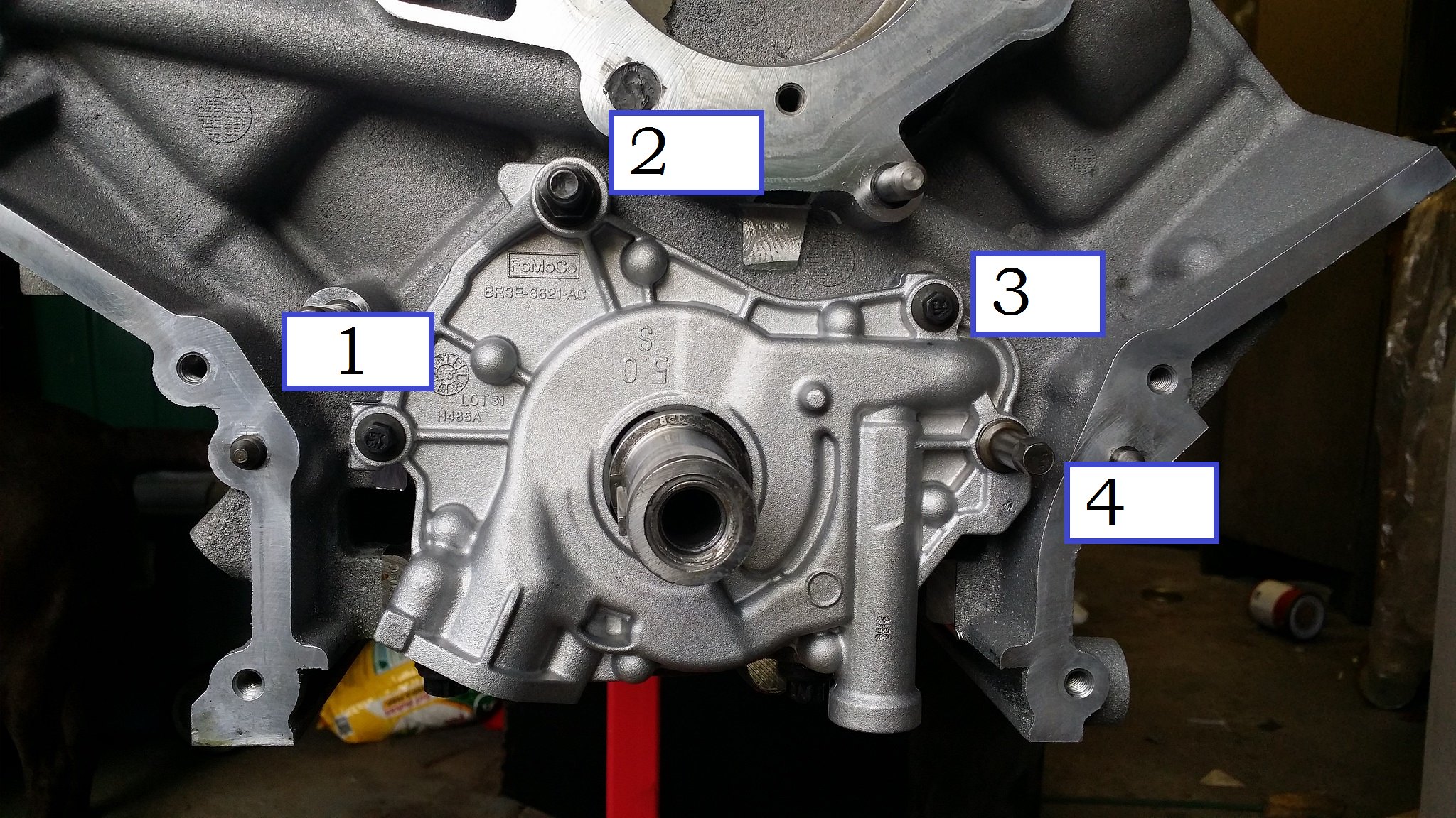

I also turned my attention to the oil pump now and torquing down those bolts. The oil pump has some unique steps to it so be sure to follow the torque sequences for each bolt. See the picture for reference.
Torque Specs
  • Oil Pump Bolt #1 - 8mm / Oil Pump Stud #2 - 13mm / Oil Pump Bolt #3 8mm / Oil Pump Stud #4 9mm
  • Stage 1 - Hand tighten
  • Stage 2 - Bolt #1 89 lb-in / Stud #2 18 lb-ft / Bolt #3 89 lb-in / Stud #4 177 lb-in
  • Stage 3 - Bolt #1 additional 45 degree turn / Stud 32 additional 75 degree turn / Bolt #3 additional 45 degree turn / Stud #4 additional 60 degree turn

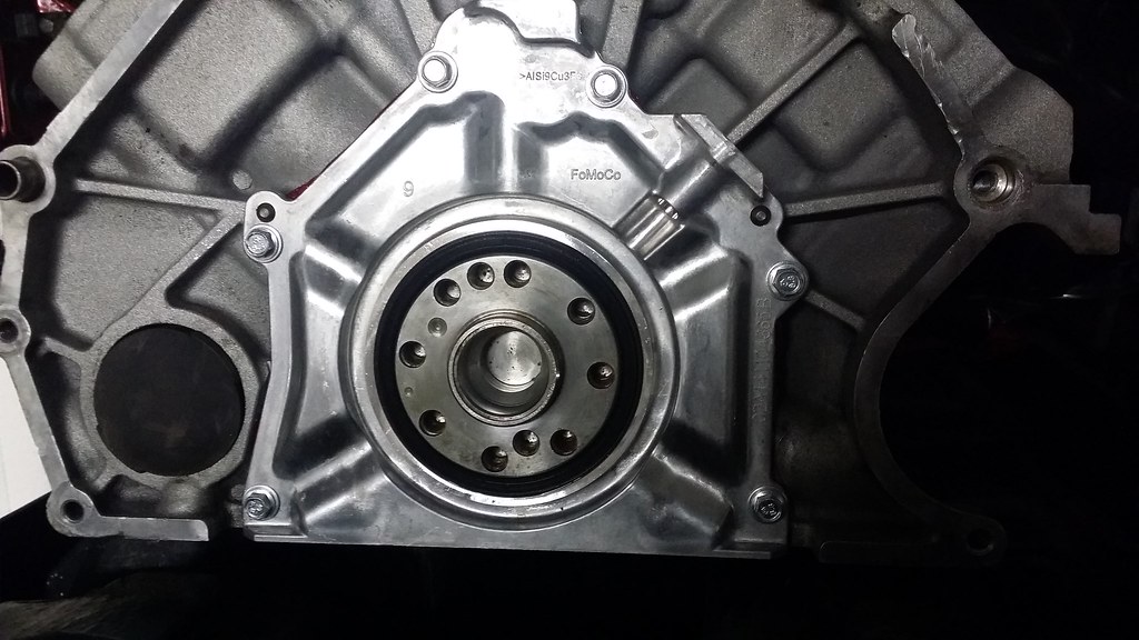

Last night I got the rear main seal plate put on the back of the motor. Using Permatex Anerobic Gasket Maker. I put a bead of this on the motor .According to the service manual, you put the bead on the motor, not on the retainer plate itself. I don't have a picture of this as it was night and I just wanted to get inside and shut it down for the night but the rear main seal is on.
Note: When putting this on, use a continuos bead of gasket maker and do not move the plate sideways when placing the plate on or as per the manual, you stand a greater chance at having the gasket leak. That would be a giant pain in the ass considering the location of the plate.
Parts list
  • Retainer Plate - BR3Z-6K301-A
  • Retainer Plate Bolts - W714962-SXXXXXX (I don't have the last part of the Part number for the bolts.
  • Permatex Anaerobic Gasket Maker - 51813
Torque Specs
  • Retainer Plate - 10mm - 89lb-in + additional 45 degree turn
  • Follow sequence below

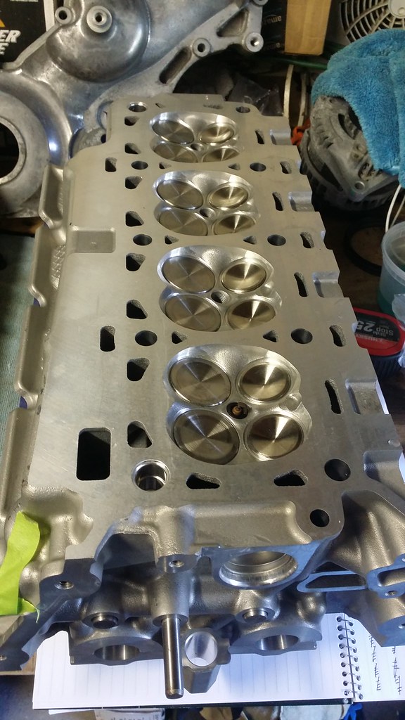

The 2015 heads come bare with just valves, valve springs, and keepers so I also needed to get some roller followers along with the lash adjusters. I had the heads shipped to me and got them all ready to be put in. I have to say they are a work of art IMO. Trick Flow Valve Springs, RGR bronze valve guides Ferrea oversized valves, and a nice port work to the intake and exhaust ports along with some bowl work and a whole slew of things I am probably forgetting.

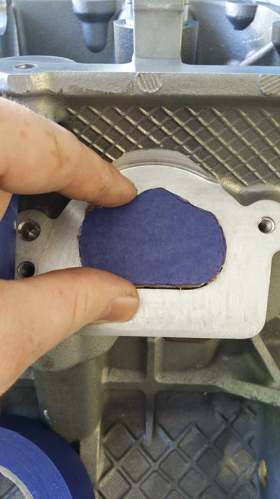

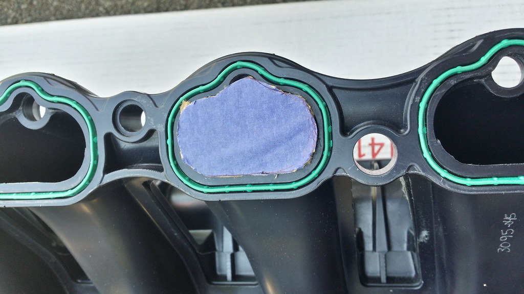

That being said, there have been people noticing that their Cobra jet Intake Manifolds intake runners were much larger in size than the intake ports are on the heads. That will cause a little bit of loss in power than if the ports were matched in size.So I took some painters tape and grabbed my x-acto knife and traced the intake ports on the manifold and transferred that over to some cardboard. Well would you look at that
Perfect fit! Don't mind me holding the piece on the head, if I had let it go, it would have fallen down the intake port and I really didn't want that to happen.
From this point I wanted to calculate my compression ratio so I needed to know the combustion chamber volume so I grabbed the tools needed (sorry no pictures of this). You need your spark plug as the spark plug takes up a specific volume in the combustion chamber, a piece of plexiglass with a hole cut in the center, some sort of way to measure the liquid going into the Combustion chamber (a syringe works as it has a marked volume on it), some vaseline and some water. The first thing that I did was to level the head so I grabbed a bunch of coffee filters I use to clean parts and folded them up until I got the heads nice and level. What you are doing is taking your water and filling up the combustion chamber with a specified CC's of water. The factory size is 54.5cc's so when you get to this point you take some vaseline and put it around the combustion chamber to seal the chamber off, now take your piece of plexiglass and put it over the combustion chamber. From there you can continue putting water in the combustion chamber. When you start to get to the top of the piece of plexiglass, you stop. Subtract what you have left in the syringe from the volume of the syringe and add up how many times you added water into the combustion chamber ie. if you have a 10ml syringe (although mine was .5ml URGH) and you filled it 5 times and you have 4 ml's of water left in the syringe you have a combustion chamber size of 56 cc's.
Now that I know this I can go ahead and calculate my compression ratio. While there are calculators out there that will do the math for me, I like to do this sort of stuff so I sat down with a pad and pencil and went about calculating the compression ratio myself. While there are a certain number of ways to calculate your compression ratio, I decided use a technique called slicing pi as it seemed the simplest and easiest way to do this.
Bare with me as we are about to embark on a treacherous journey into the world of ...... MATH
When calculating your compression ratio there are 5 variables that we are going to need to find and we are going to need to solve for. In looking at the ways to find your compression ratio I saw this video and it stood out to me as the most detailed and concise way to find your compression ratio. Beware though, it is 20 minutes long but it is very thorough in the explanation. I have also found a love for Jafromobile and his videos now because of this.
Anyway, snap back to reality and math!! Ok, so the variables that we need to solve are as follows:
V1 = Swept volume - Here you are calculating the engine volume based on the bore and stroke of the cylinder.
V2 = Gasket volume
V3 = Piston to deck volume - Here you are calculating the distance between the piston at top dead center and the deck
V4 = Piston volume
V5 = Head combustion chamber volume
Getting my measurements
I know what my bore is based on the proposed measurements brought forth by RGR & JPC. I don't have a dial bore gauge to calculate my actual bore but when I measured it with my dial caliper at the top (I know this is entirely wrong and un scientific but I didn't have the right tools available to me at the time) it measured out 5 times to an average of 3.699 in, so I am confident in their measurements on stroke as well which I know is 3.800.
In order to find the crushed gasket thickness of the gasket I am using I contacted Cometic and asked them for the crushed measurement and they said that it will be .040 as listed on the packaging and all of the crushed thickness' will be listed on the gaskets so my gaskets crushed thickness is .040.
In order to measure my PTD clearance I had to find TDC on the number 1 piston. Out came my dial indicator and stand that I got with the Comp Coyote Camshaft Degree Kit. Unfortunately, I didn't have anyway to securely fasten it to the deck so I had to hold it steady by hand. Not an easy task to do when you are trying to rotate the engine at the same time. Anyway, it ended up taking me about an hour to find TDC and then I spent another 45 minutes making sure that it was true TDC which ended up with me double checking my measurements 8 times. So, I set TDC and grabbed my smallest feeler gauge and went all the way around the entire piston and couldn't get it threw so I knew the gap was at least .004" I checked with Eric over at JPC about this and he said that Rich makes sure he zero decked the engine. Considering I couldn't get a .005 feeler gauge in there nor could I see daylight between th piston and my straight edge I am pretty confident that is the case.
My pistons are a flat top piston with a .70 valve relief cut in them.
Head CC volume using the method outlined above is 57cc's

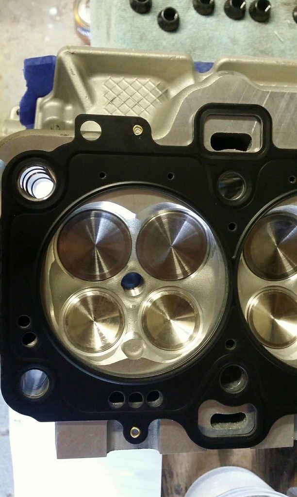

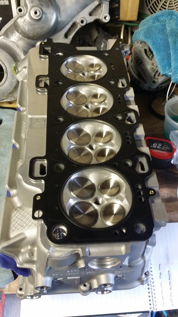

Back to the fun stuff. After I turned my attention away from math and back on putting parts on the car, I put all of the ARP studs back in. I went down to the bottom of the holes because if I turned them half a turn, they were wobbly as shit and it wasn't something I was confident in. Studs went back in the engine and out came the Cometic head gaskets for a 11-14 Mustang. After lining up the head gaskets on the heads, it looks like everything lined up and is all set. So in case anyone is wondering. 2015 heads fit on the 11-14 block and with 11-14 head gaskets without issues.
Head gaskets got put on the deck and then the heads got put onto the block followed by the ARP washers and ARP nuts. As per ARP instructions I used the ARP assembly lube and put some on the threads of the studs as well as the nuts. It may have been overkill but oh well. I asked around bout the torque procedure at Tim Eichhorn over at MPR Racing Engines told me what he uses for the ARP bolts.
Parts List
  • 2015 Heads - FR3Z-6049-A
  • 2015 Heads - FR3Z-6049-B
  • Cometic 94mm Bore MLS .040" Gasket Right - C5286-040
  • Cometic 94mm Bore LMS .040" Gasket Left - C5287-040
  • ARP Head Studs 11-12 Block - 256-4702
Torque Specs
  • Step 1 - Hand tight
  • Step 2 - 30lb-ft - I waited an hour before continuing on
  • Step 3 - 30lb-ft again
  • Step 4 - 50lb-ft
  • Step 5 - 70lb-ft
  • Step 6 - 90lb-ft
  • Step 7 - 110lb-ft
  • Step 8 - Wait an hour and 110lb-ft again

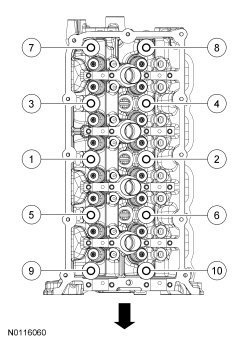

Follow the head stud torquing sequences below for each side
