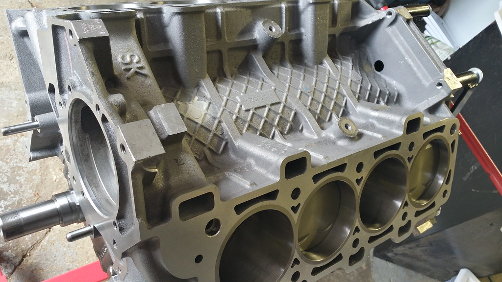

RGR and JPC have my heads and all I need are the cams and I can begin reassembly. I have to make time and talk to them tomorrow about getting everything else done like gaskets and what their opinions are on that sort of thing but hopefully I will have it done before the AM show.
