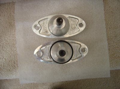

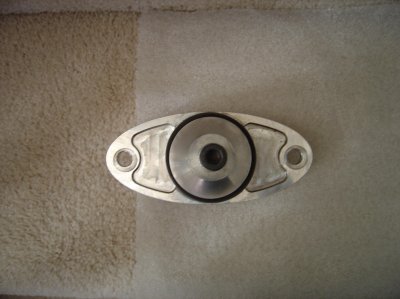

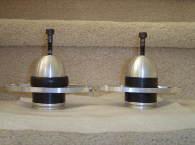

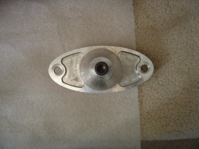

I just had this happen yesterday. I have a bigger gap in mine then you have in yours. The top bushing had sagged enough my headers started hitting the frame rail. I put a piece of 1/4 inch steel under each mount location where the screw attaches the mount to the body of the car. Raised the motor about 1/4inch and took care of my problem.
