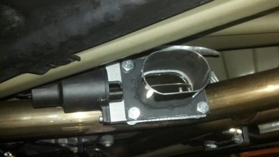

Whether you have cats or not doesn't make a difference. Here's a pic of mine.

They are the low profile. I got them from Summit Racing. Stock Mustang exhaust is 2.5".If your installing them yourself let me know and I'll give you some tips on the installation. Your going to need a hacksaw, Dremel and a welder. I used the left over pipe from the kit to make the exhaust snouts bolted to the valve in the photo. Run your wiring up through the shifter tunnel. I drilled a hole in the tunnel wall to bring the wiring inside the console. There is an unused connector in there for an auto trans console that you can tap for power. I ran the toggle switch coming out the side of the console just under the ebrake handle. Push forward to open, pull back to close. Have had them almost a year now and they still work great. If you got cams like me it will sound bad ass. I get compliments everywhere I go except from Prius pricks lol.
