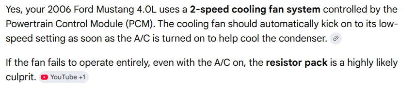

My guess is the fan cooling assembly is failing, and the low-speed setting has failed altogether. The gurgling is due to overheating because the low-speed fan isn't working at all. The high-speed fan should rarely come on if at all, so if yours is, you are overheating, and the low-speed fan isn't working.

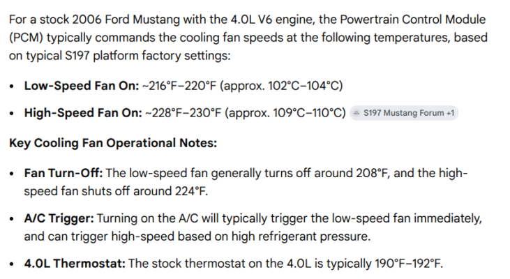

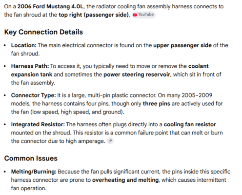

Also, disconnect the harness connector from the fan assembly and look at the inside of the connector. The pins shouldn't show any signs of heat or melting. If that fan motor has seen its better days, and it is struggling to run and is drawing a lot more current to run, it could well melt the low-speed resistor pack and or harness connector to the fuse/relay box.
When I replaced my Fan assembly with a Ford Performance 7-blade 2013-2014 Fan assembly, I checked my connector, and it was fine. I also installed the WireEverything dual relay 8-gauge wire harness to eliminate all these issues. And my car only has 12,000 original miles. I did all this to make sure this common issue doesn't affect my car in the future. I also reset my low and high speed temp on settings to 206(Low) and 216(High) with a SCT tuner.

Do you know where I can find the connector in the car?

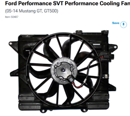

Yep. I had done some research on this issue. My car hadn't experienced this issue, but I decided to make sure I didn't, so I purchased the Dual Relay Fan Harness from WireEverything, and I also purchased a new Ford Performance SVT 7 Blade 2013-2014 Fan assembly for my car. This project was done in Feb 2026. The install went well, and now my new fan assembly bypasses the fuse/relay box entirely and runs the 8-gauge wire to the battery ground and is connected to the power input terminal entering the fuse/relay box. The update sure is a great piece of mind!!! :cheersman:
New fan assembly. This puts out 40% more air than the stock cooling fan, and it now runs on wires that can handle the current.

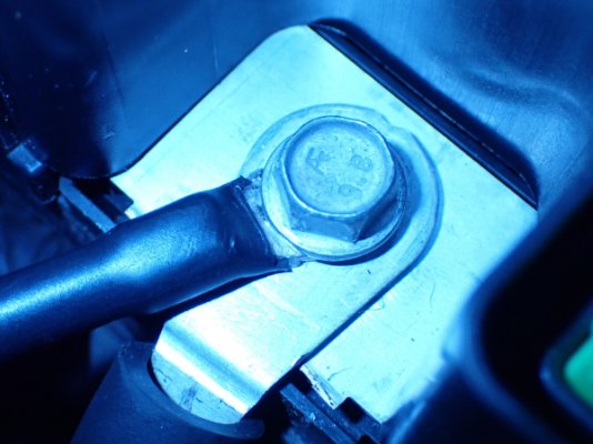

Power connection to the Strut Tower side of the Fuse Box with a new 8-gauge terminal from the Dual Relay Harness.

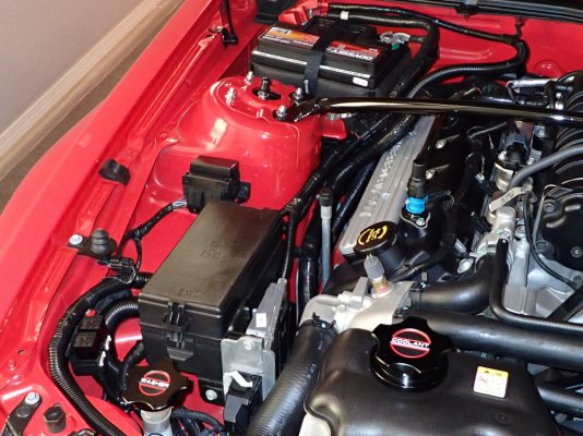

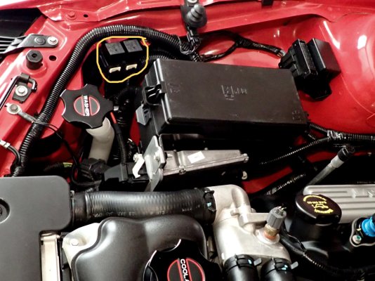

Dual Relay Harness Location I picked.
