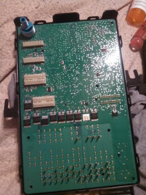

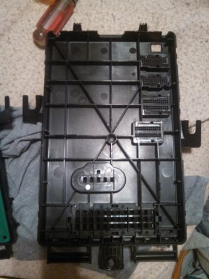

Inside of sjb, I couldn't get lucky and find any defective or pushed out pins with my eyes, not sure if a fried sjb would even be noticeable to the eyes. Any worth to check these pins with a multimeter? And how to find pos and neg on which pins?
Sorry, I really need to know what I'm looking for.
Thanks

As mentioned check for voltage to power dist sjb.

I went back and read your original post... You mentioned trying to find a ground for a gauge and kept mentioning the "passenger side fuse box"... I'm assuming you are talking about the one in the engine compartment. You also talked about the Tyco plug on the fuse box coming loose.... Again I assume we are still talking about inside the engine compartment.
So my question is when did we get inside the car to the SJB? I'm not real clear as to why the SJB is suspect.
If you were messing with the connections at the fuse box in the engine compartment and the connector came loose... I would be starting there. You might have to probe each wire just away from the plug and see if each wire that is supposed to be connected to a fuse is actually making contact with the wire.
