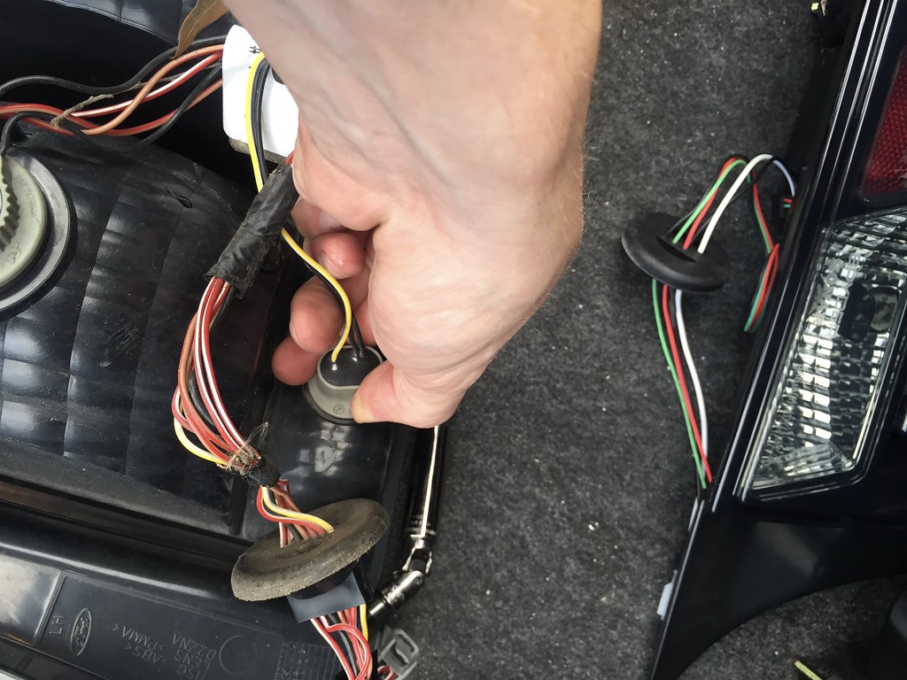

Open the trunk, remove the trunk mat, and remove the interior trim panel. There are two plastic screws and 4 push pins that hold the trim panel in place.
Once the trim panel has been removed, remove the 3 lamp mounting nuts on the drivers side.

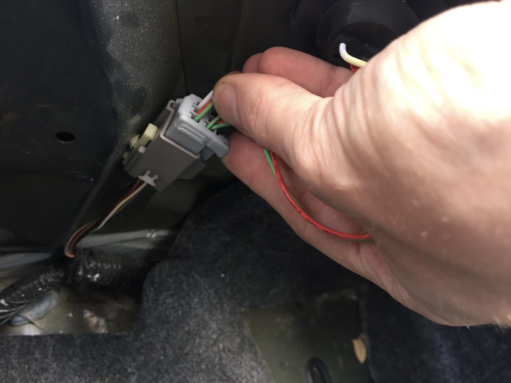

Disconnect the wiring harness, pull the lamp assembly out, and gently pull the wiring harness through the hole in the body.
Remove the reverse bulb from the factory lamp assembly and transfer it to your new Vector tail light.

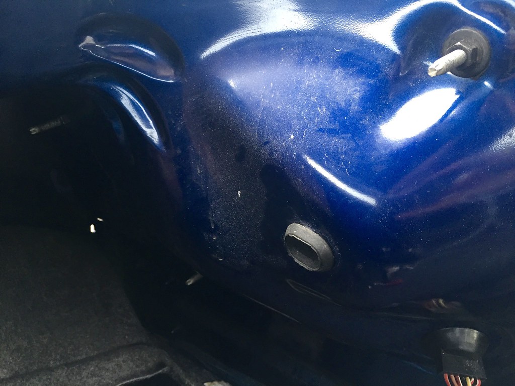

Pull the Vector wiring harness through the hole in the body. Be sure to fully seat the grommet, or you may get water intrusion. Connect the wiring harness to the body harness.
Position the Vector light so that the 3 mounting studs line up, and push them through the body. Fasten the lamp in place with the 3 mounting nuts you removed, torquing to 6 Nm. These just need to be snugged, so don’t overdo it!

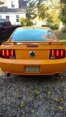

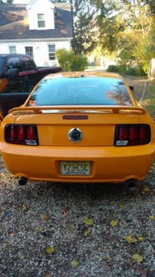

here are mine, I have the red diffusers. Now the description for them says they don't sequence when the hazards are on but mine do.
