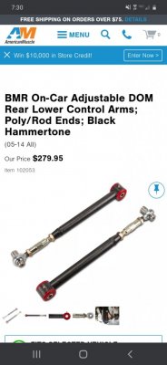

The Whiteline video on AM's site was very enjoyable, especially Stephanie. Looks like my linked eBay specials are a knockoff of this KTA-195 piece. I'm tempted to get the copies just to have a look at the design, the welds, and the quality of the components. If they fail the eyeball test, I'll send 'em back and order the pricier ones.
In some racing applications the rear control arms are designed to be the weak link in the suspension - saving damage to more expensive components by bending to absorb a lot of the energy in a minor crash. Been there, done that, got back on track for the next session with straight corners; this was after the other guy tried a silly pass on the last lap of open qualifying, locked up, and hit a rear wheel on my car.
Nothing against drag racing - watch it all the time on YouTube, and more of the local car guys are into drags than into dirt tracks. The GT is plenty enjoyable without testing its launch capabilities. My goals with adjustable lca's are fixing thrust angle [for better turn-in and high-speed stability] and eliminating driveshaft vibration [if caused by improper pinion angle].
