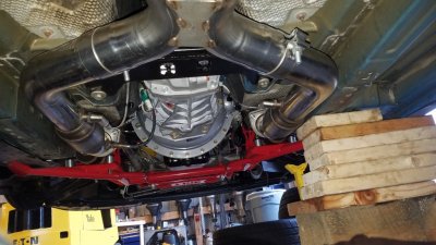

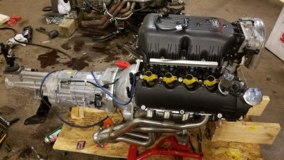

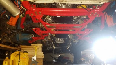

AE4B8031-AB76-4107-A9CD-87320F3863A8.jpeg F52296E2-A84A-47BE-924A-E1F78FAFC274.jpeg 0FB4DFBD-7177-46C3-8F9A-BA8429C495FC.jpeg BF3D6323-B8A3-40CC-B51F-890B5ED336E4.jpeg 4AFA6499-06D8-4122-BF63-203A01DBD270.jpeg I was not really sure how to title this but here goes. 2 years ago I installed a brenspeed b326 stage 3 stroker motor with a new t-56 magnum xl transmission a Paxton 2200sl with 3.12 pulley and 10% overdrive pulley. I had it tuned and was putting down 642 rwhp.
2 weeks after getting my car back I brought it in for an inspection sticker and the shop took my car for a joyride and blew my motor.
Now after a 2 year legal battle I am at the point of rebuilding the motor again and would like to ask a few extra questions.
I would like to get to the 750- 800rwhp mark and this is a 90% street driven car.
1. I have twin gt500 fuel pumps with dual kenne bell boost a pumps, upgraded wiring and 78lb deitchwerks injectors. And a methanol injection kit. Would this be enough fuel?
2. The Paxton 2200sl currently has a 3.12 pulley. If I go smaller do I have to upgrade to 8 rib pulleys and if so which ones. I would also want to make sure I was not overspinning the blower.
3. The suspension is completely upgraded but what can the rear end axels and diff saftley handle as I have not upgraded it at all.

That should be enough injector and with the BAP on top of the GT500 pumps, you should be fine. 60's and GT500 pumps without the BAP go over 700 rwhp on GT500's regularly.
The 2200 is plenty of blower for that power level as well.
As for the differential carrier, it is usually a dead hook that kills it. I am yet to see someone break one of the 31 spline stock axles without something else breaking first. I went with a locker and it is definitely not for everyone-it functions great at the dragstrip but does not do parking lots well and is noisy.
