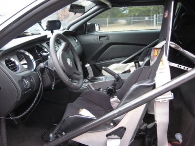

sorry its a crappy cell phone pic

Yeah mine are much closer to the back bar as I am taller then Matt. Wait, I think everyone is taller then Matt........
I used the Kirky brackets, but since I wanted the seat a little further back I need to use a spacer between the bracket and the floor board because the rear mount is off of the "seat pad" location of the stock seat.
I have an "L" bracket that comes off the rear bar and is bolted to the seat also, in addition to the four mounting points on the floor board.
The belts --- the shoulder belts wrap around the rear bar, the lap belt I use the stock mounting points that the original seat belt used. The submarine belt is just bolted down underneath the seat.

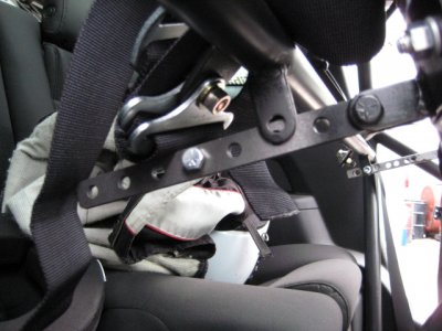

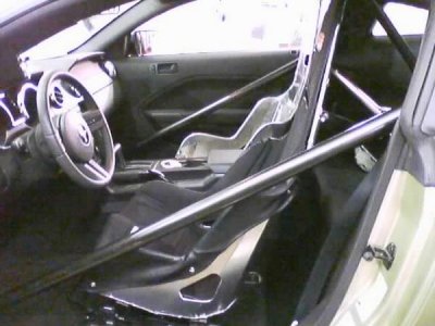

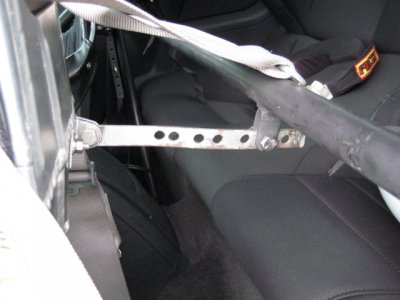

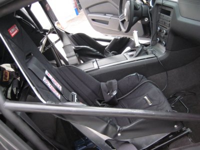

for "street cars" we mount the kirkeys to stock manual brakets so when tooling around town they can be slid back, and then moved forward into "race mode" lol
Also make an adjustable seat back brace so it can be braced at any position.

there ya go hope that helps
The last two pictures are with the brace Down then up. You can see how we put several holes to it can be mounted in a few spots. usually the seat isnt that far back thats why its hitting the seat belt stuff
