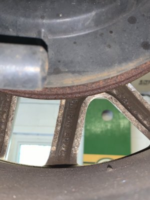

Looking for the best way to restore/clean the inside of the rim. It has a good amount of buildup and some corrosion. I have added a picture, TIA.

Cheap way would be to wash/clean yourself w/ basic cleaners & steel wool. Spendier method is to have them blasted & sealed.
You don't necessarily see the inner part of rim so...any reason why you're looking to pretty them up?

Just wasn’t sure if all that junk on the inside of the rim was bad for it and it would continue to build up corrosion. My thought was more of a preventative measure.

Any rim cleaning product does well. I've used a few. Rinse with water, spray with cleaner, let sit, scrub, spray off with water. Don't do it on your lawn. Easier with tires off.

It won't be the end of the world to leave alone though. That build up looks like dirt and break dust, no rust. So you probably could clean without an abrasive and be ok.

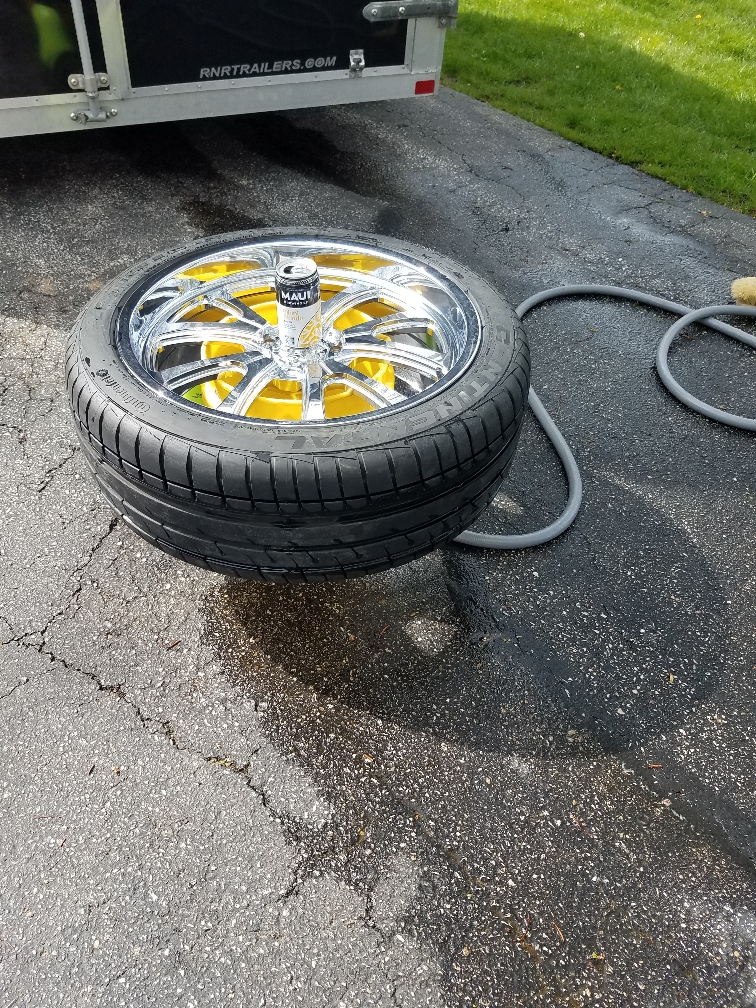

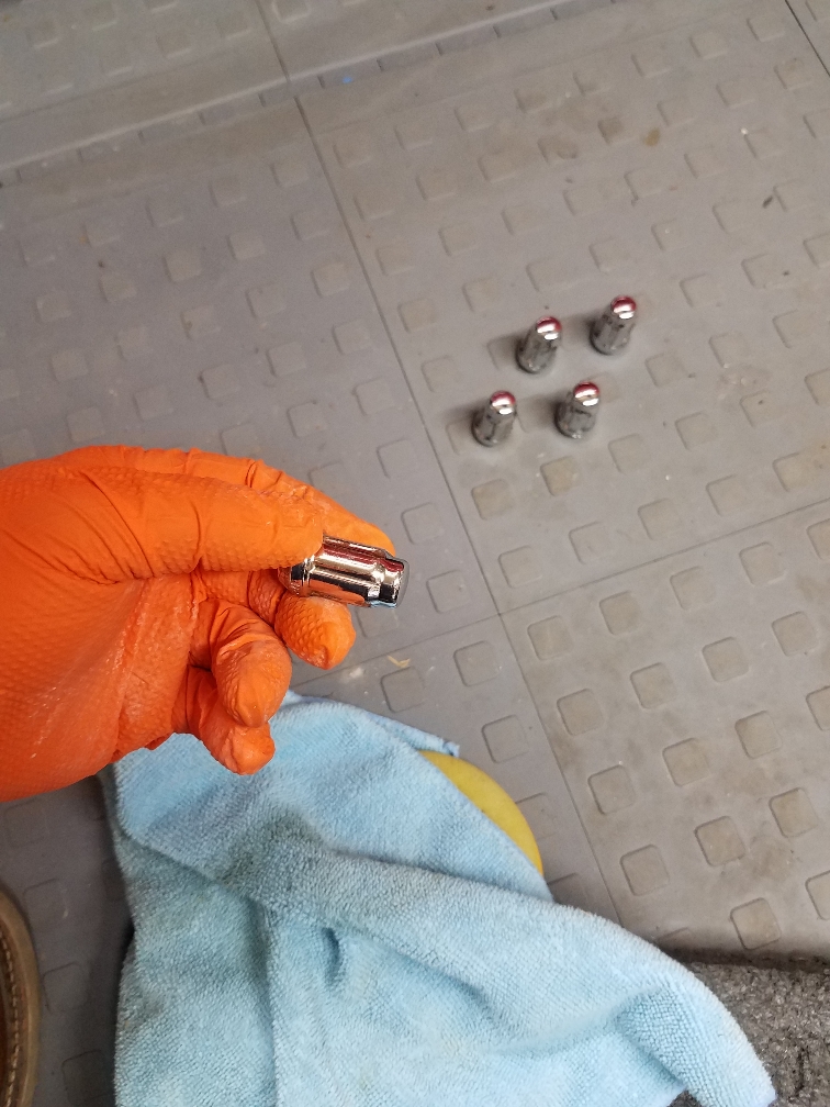

Just cleaned all mine last week. Simple green, a white scotch brite pad and time. A rag for chrome/polished faces. Final was to use metal polish inside and out. Mine were pretty dirty, I had to clean them twice on the back sides.

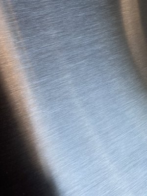

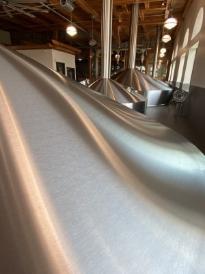

You can scrub polished stainless with white scotch brite/3m pads without scratching. My preference is doodlebug pads.
I build a lot of stainless steel railings along the lake here. They're all brushed finish with cables and all get polished with multiple 3M scotch brites. I do use white on appliances occasionally to remove light scratches, well at least on wolf and viking that is. Never herd of doodlebug pads.
I’ll give you some more specifics and show you some examples of what I trust to scrub with them which is basically any delicate surface that needs scrubbed without leaving scratches.
