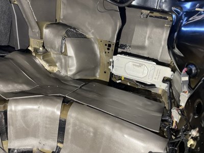

When you use dynamat or any sound deadener in addition to the trunk and rear seats you also want to run up both sides of the rear seats and cover the wheel arches in the trunk. Also recommend doing the front seats all the way up front as far as you can get to easily and exterior front tubs behind the front wheel arches. When I do a car I buy the stuff below in bulk. 50 sq feet will easily do an entire car. It's gotten more expensive but still a bargain when compared to what other mainstream products charge. I've done two cars now and both are significantly quieter compared to when I started. It does take a while however. I probably have a good 50-80 hours in each car. Still worth it.

When I dynamated the back, I did cover the wheel arches but I was limited in my access to the sides of the rear seats, how do I remove the armrest panel?

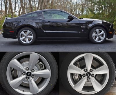

As far as specific tires, without changing rims (I have the crappy 16 radius rims, probably not going to change this) what are my best options?

I've found that Rockmat does a much better job of knocking down noise compared to Thinsulate. Removing armrest panels is straight forward. Remove plastic door scuff panels; then rearseat; then backrests. There are three pin type moulding retainers (one in the front down low; two in the rear) that you'll have to remove (should be able to get them out with a screwdriver or panel remover if you have one). Then the armrests just pull out starting with the rearward sides; pull inwards/ forward. Installation is the reverse of removal. I'm sure there's probably a youtube video on it.

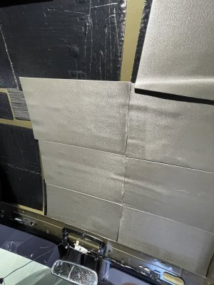

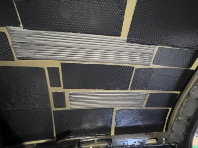

I used the Noico LMV and their acoustic foam on top of it. The foam was a big improvement over just the LVM.
Both are available on Amazon and cost much less than the name brand stuff.

The roof liner I haven't done yet. Concerned I'll mess up the stock liner. Difficult/easy to get out?
Kobie
Dec 23, 2007
198
I was worried too, but it ended up being super easy. Comes out in one piece. Goes back in easy too. Big improvement in sound and heat transmission.
