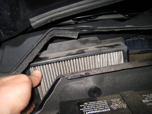

Probably water intrusion at the Smart Junction Box. Check the 2 firewall drains. They are known to get clogged and then rain water or car wash water can't drain properly. It ends upo going through the cabin air filter into the vehicle. While in there replace the cabin filter. That gets done from under the hood. The windshield cowls have to come off. It's behind the firewall behind that battery.
