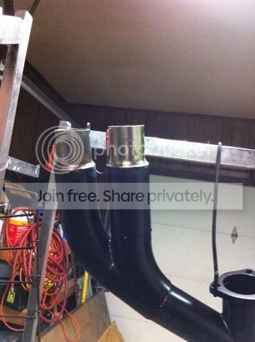

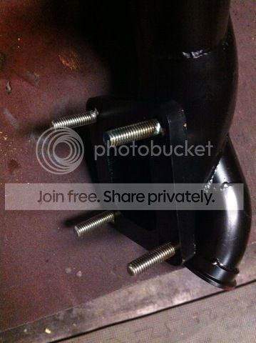

JeremyH
3V Fuel Guru
Jan 10, 2009
20,857
207
Virginia Beach
Ingwe
Sun, Sea, Sand and Camels
Jun 28, 2009
510
Dubai
That looks awesome guys. Can't wait to get mine!
