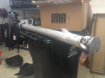

Alright so theres been a lot of replies since I last stopped by.

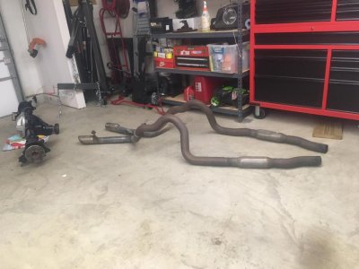

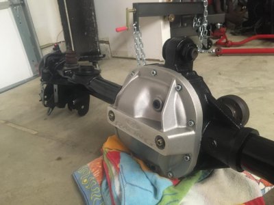

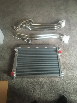

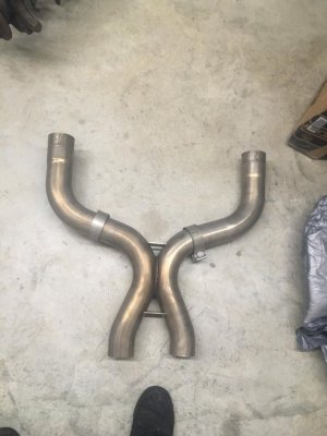

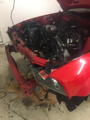

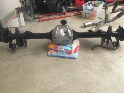

Right now the car is finally being put back on its wheels by tonight. It has a rebuilt 8.8 installed (3.73s all fresh bearings etc, spent long hours sanding and prepping to paint it and it turned out pretty good) and added the ford racing cover. The axle was had for $350, and a one piece aluminum driveshaft (11-14 but mated for 15-17 motor), the exhaust system was had for $675 all together headers/xpipe/overaxles, I did buy a UCA for the rear because it was the only stock suspension I still had in the car and figured it would be a good time to replace it was pretty fucked, went ahead and bought a new radiator and outside of sourcing motor/trans which were very limited the last six months it seems, most everything is complete in terms of prepping the car. Harness is on backorder, and I still have to install fuel system at this point but the project slowed down quite a bit just because I had to catch up on other ordeals.
I also forgot to mention that at this point the plan is to put an 18+ digital gauge cluster since a 15-17 ECU will work with that and obviously unless I pay a professional to convert my cluster to work its not worth messing with the old cluster. Also, I'd like to point out that if you have people to help you, there is really no going wrong with some help. There were some things I spent way to long doing simply because I did not have an extra hand. Save yourself the cuts, bruises, and time and get help taking things out or off. The axle weighed like 300+ and the hood is a nightmare to move for one person.
